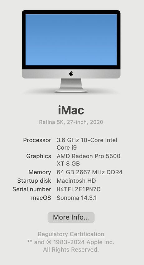

Ever since I updated Mac OS to Sonoma, TVAI bricks my Mac while converting. It seems to clip either the GPU or CPU I can’t tell but I do know the fan spins up quite a bit before it bricks my computer. I then need to hold the power button down to shut down the computer, it then takes about 20 seconds before it will be begin to reboot and the Mac feels very hot to the touch so I think it;s overheating the GPU. This was never an issue before Sonoma and I would let movies run overnight without any issue, this is specific to Sonoma and has only been an issue since upgrading. I even ran VAI version 2.6.4 and it still bricks but it takes much longer. I have attached my system profile so hopefully this helps diagnose the cause. At this point VAI is useless to me and I have been using for 2 years without issue.

@matt.lonzi: I can only think of three “solutions”:
  1. Try the Sonoma 14.4 Beta if this solves things again
  2. do a downgrade to Ventura (OK, I know this is painful)
  3. Try to enable the “low power mode” in TVAIs settings (under “Processing”). But this will likely bring a big speed penalty.

I have enabled low power mode and it has made a big difference. I have been running VAI for about 30 minutes along with Youtube and there has been no issue. That said, it leads me to believe that VAI is clipping the GPU causing it to freeze. Perhaps Topaz can have a suggestion pop up when launched on Intel Macs running Sonoma to run it in LP mode to avoid any crashing/freezing issues.

Our developers are currently in contact with Apple about an issue related to Mac systems with AMD graphics cards. We don’t have a full solution currently but you can change the max memory % in the Preferences Panel to 20% and turn on the low-power mode.
Without a solution from apple to address the hardware issue we are not able to move forward on this. You can open a ticket with the Support team for further options.

I have enabled low power mode and reduced the memory maximum to 95% and there has been no issue the past few days. It does run slightly slower but the results are working.
