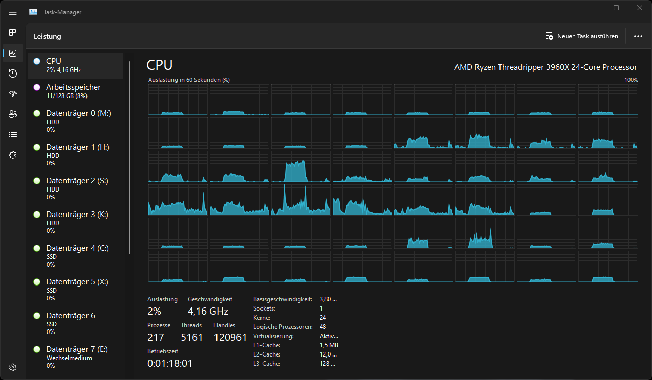

As far as I can tell, it is due to the CPU load, according to HW info about 10 cores are used.
In the task manager I can see that all cores are used, some more and some less.
