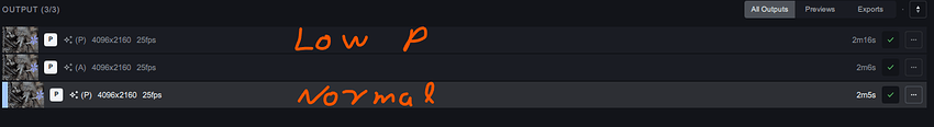

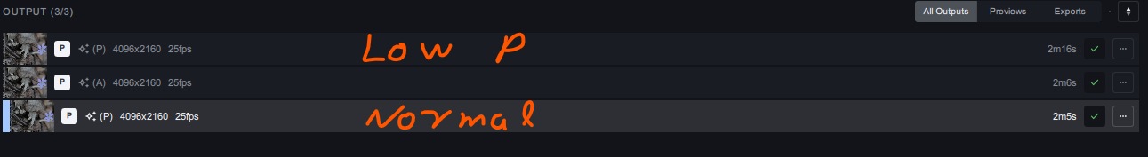

Low Power Mode: ²
After switching back to normal the performance did increase.
After further tests I found that sometimes it makes a difference, but sometimes not.

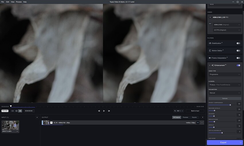

Alpha 3.1.7.1
Proteus & Artemis low
Stable 3.1.6
