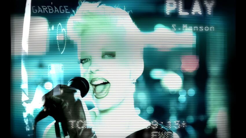

I’m here to show you two scenes where Proteus v2 is the model I’ll be using.
When there are supposed to just be lines, Proteus 3 and 4 and all of the Iris models gives us Arabic looking text… I literally screamed out " Hallelujah!" when I discovered Proteus 2 doesn’t stuff up the lines.
You’ve done goofed with the models I think. Can’t you go back to where you were with Proteus 2 and then train the new model to do the lines correctly?
So, for videos that have the line problem, I create 2 outputs to use in Premiere Pro, one using Proteus 2 and the other Proteus 4 and I’ll use the best model for the scene. This doubles the files I need to store and I’d much prefer to just use the one model!
Is there some way to combine the best of Proteus 2 and Proteus 4? Proteus 2 has the lines ability that v3 and v4 just can’t handle…
