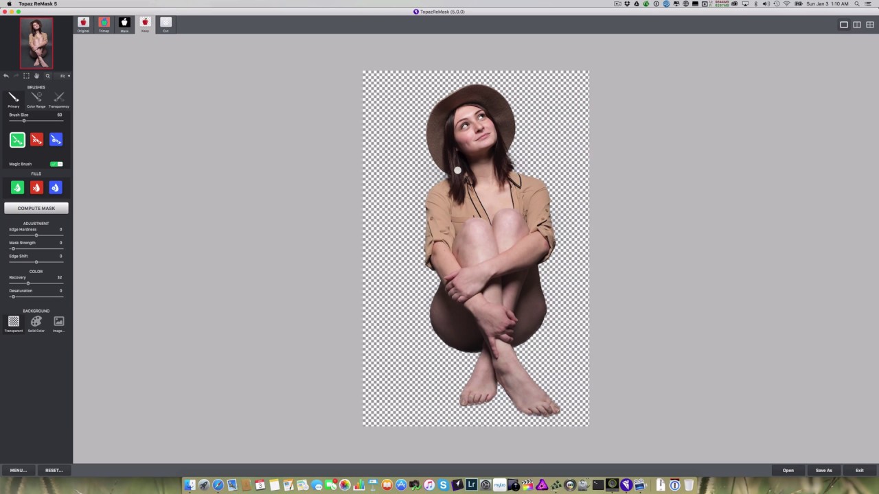

Have a look at Topaz Remask.
Remask can remove the background and can also change the transparent background to a color. I often will change the background temporarily while still correctible before finalizing. Artifacts that may not be obvious on the transparency are easier to see on a solid background.

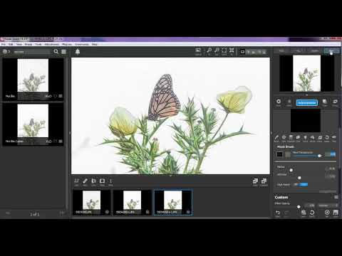

There is also a feature in Studio under Mask where a background can either be removed or simply masked.
Thanks, I will try the mask feature. I downloaded the Remask trial, but I don’t have steady enough hands to get the edge right, at least compared to the auto edge feature in clipping magic. They look at a small keep area and a small remove area and auto calculate the edge for you. Took just a few seconds. Maybe I’m just missing how to do that in Remask?
In topaz studio if you add a color adjustment layer that you set to white, 100% opacity you can than use the mask for that layer to recover what you require to remain. In my video about 50 seconds is what I mean.
Thanks, I’ll take a look!

Also, would much rather keep all my workflow in a single interface, and really like Topaz overall. But Topaz ReMask as a stand alone app is frustrating, I don’t see a way to do basic things like open an image (except when you launch it) and save a file (except when you close the app) Maybe future versions will integrate with Studio for these functions… unless this is just how the trial version works, or I’m missing something?
The algorithm in Clipping Magic is very intuitive and any cleanup was minor. I did notice that there is a limit on file size, my upload file size was reduced and that could be problematic if it doesn’t return the download file to its original resolution depending on how it will be used. The Remask trial plug-in is a full version so you are not missing anything. At some point, Studio Remask may be reworked but the concentration right now is upgrading and porting the older plug-ins into Studio.
