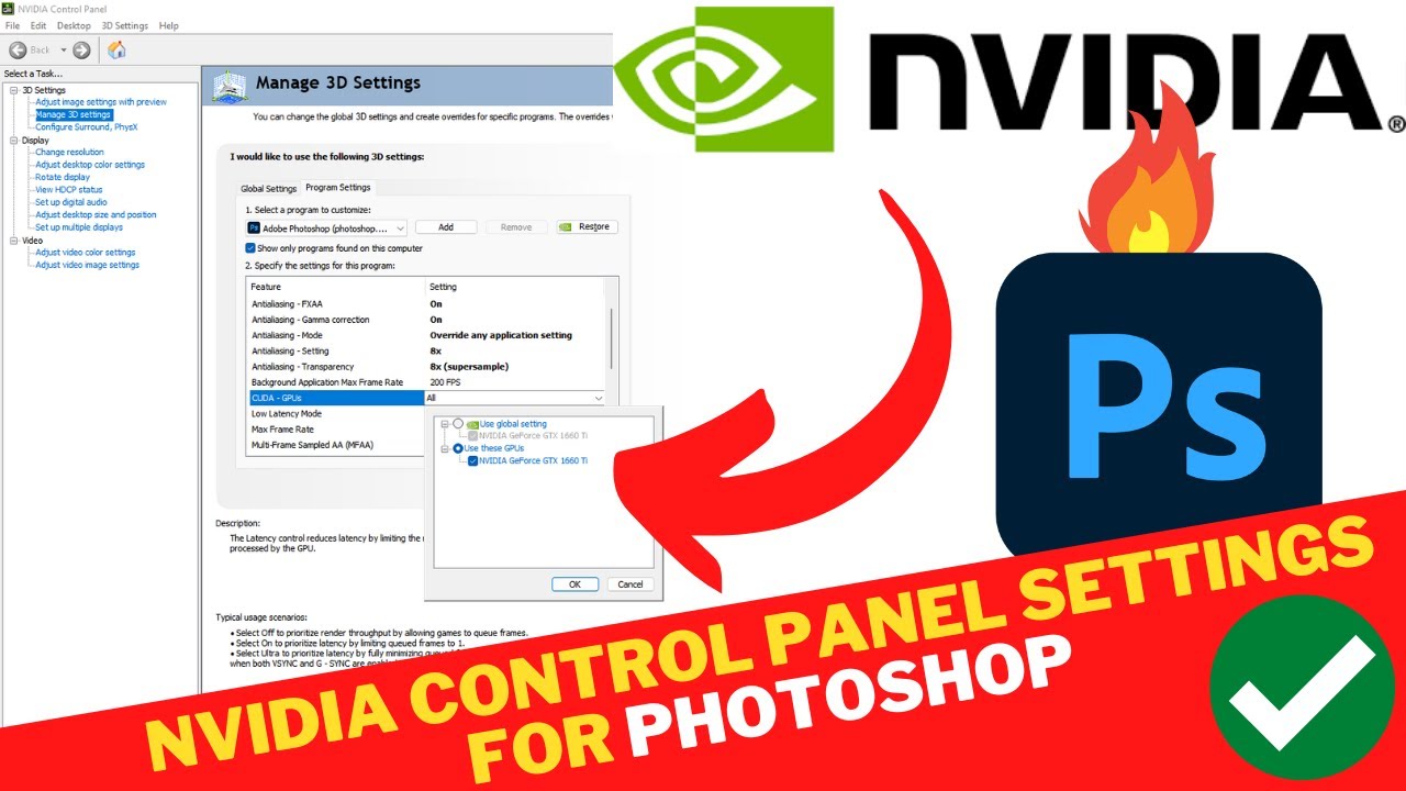

I found a setting in nVidia’s control panel that had a major impact on my setup. nVidia control panel > manage 3D settings > power management mode > change to “prefer maximum performance” (mine had been on “power”) I then updated the driver (it had only been a month) and there was an “optimize” app or game feature in Geforce Experience. From what I read I was expecting only a handful of seconds improvement, but it more than cut the time in half. On two photos the times were…
ORIGINAL SETUP / CONTROL PANEL SETTING / OPTIMIZED By GE
4 min 36 sec_____________ 2 min 22 sec___________1 min 59 sec
5min 56 sec______________2 min 55 sec___________2 min 17 sec
I never did find out if it was ram, memory bandwidth, cuda cores etc - So, I did the shotgun approach by upgrading to a 1080 gtx mini. The new times are 15 seconds on the first photo and 17 seconds on second photo.
