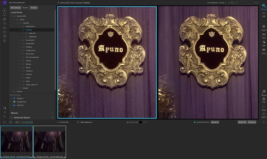

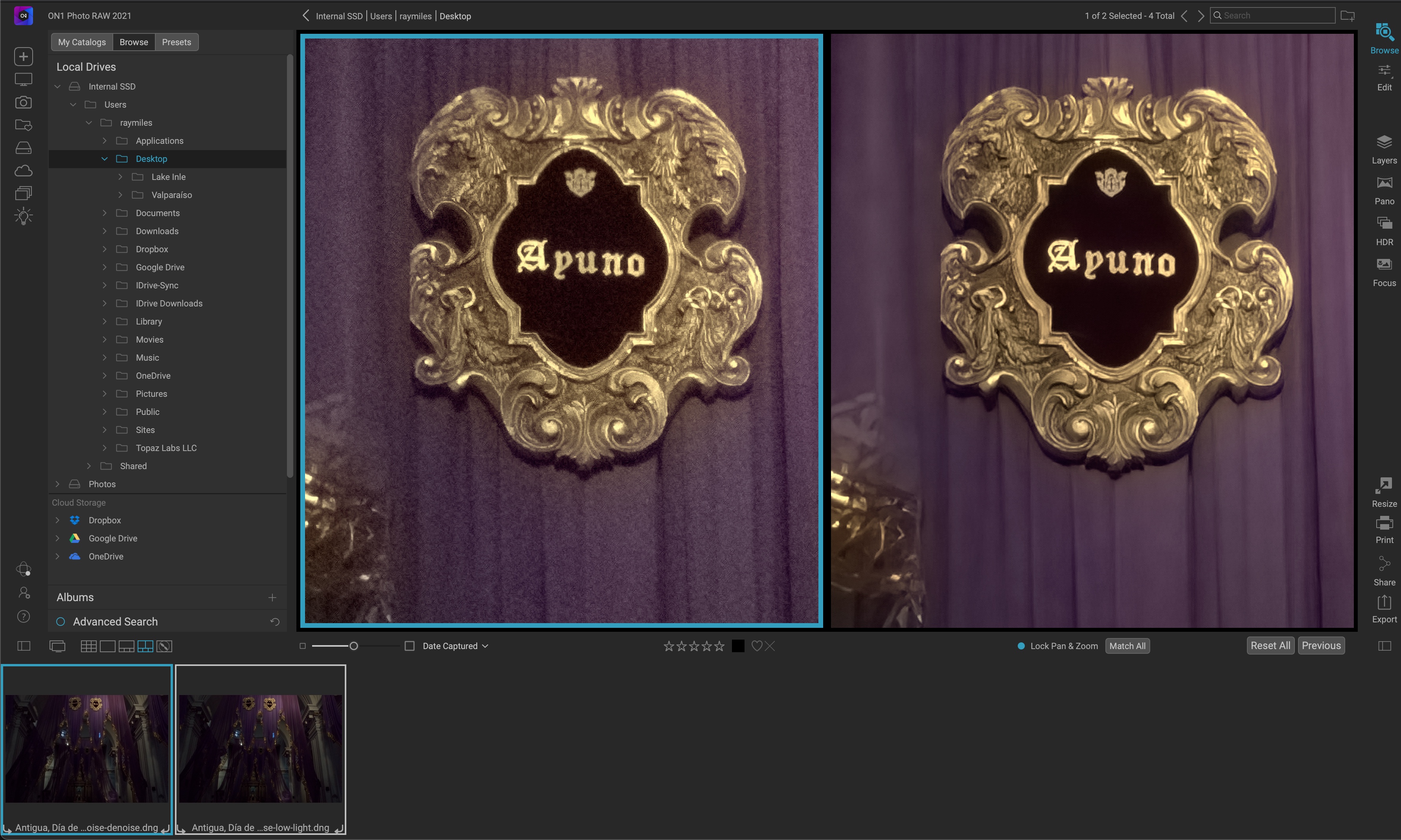

You need to find what suits you. I have found Low Light mode to be pretty useful. AI Clear can do a decent job too, but it’s often too soft. Here’s an example of Denoise AI on the left and Low Noise on the right, both in Auto mode. If I were serious about the shot, I’d probably do some fine tuning. ISO was 12800!
