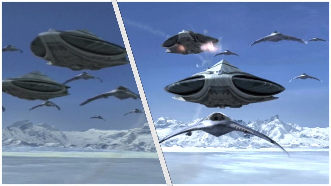

Also, Stargate PAL was a real PITA. I should mention, if you were not aware, that there is a new Bluray release for SG1 which actually had them digitally upscale the earlier episodes. I watched some and they have definitely had an improvement - it may be worth a look to compare to TVEAI.
Dropbox - File Deleted - Simplify your life
This is a link for reference for the Stargate comment above ^^
I have seen the new blu-rays, and i prefer the results with my own process. (I’m using NTSC DVDs, though) Though the offical blu-rays are definitely an improvement over the plain DVD in that it’s a lot sharper, there is considerable loss of detail compared to the DVD. Grain and texture has been cleaned significantly. It’s almost as if they’re doing basically the same thing I am, but then used Artemis instead of Gaia to upscale :wink:
