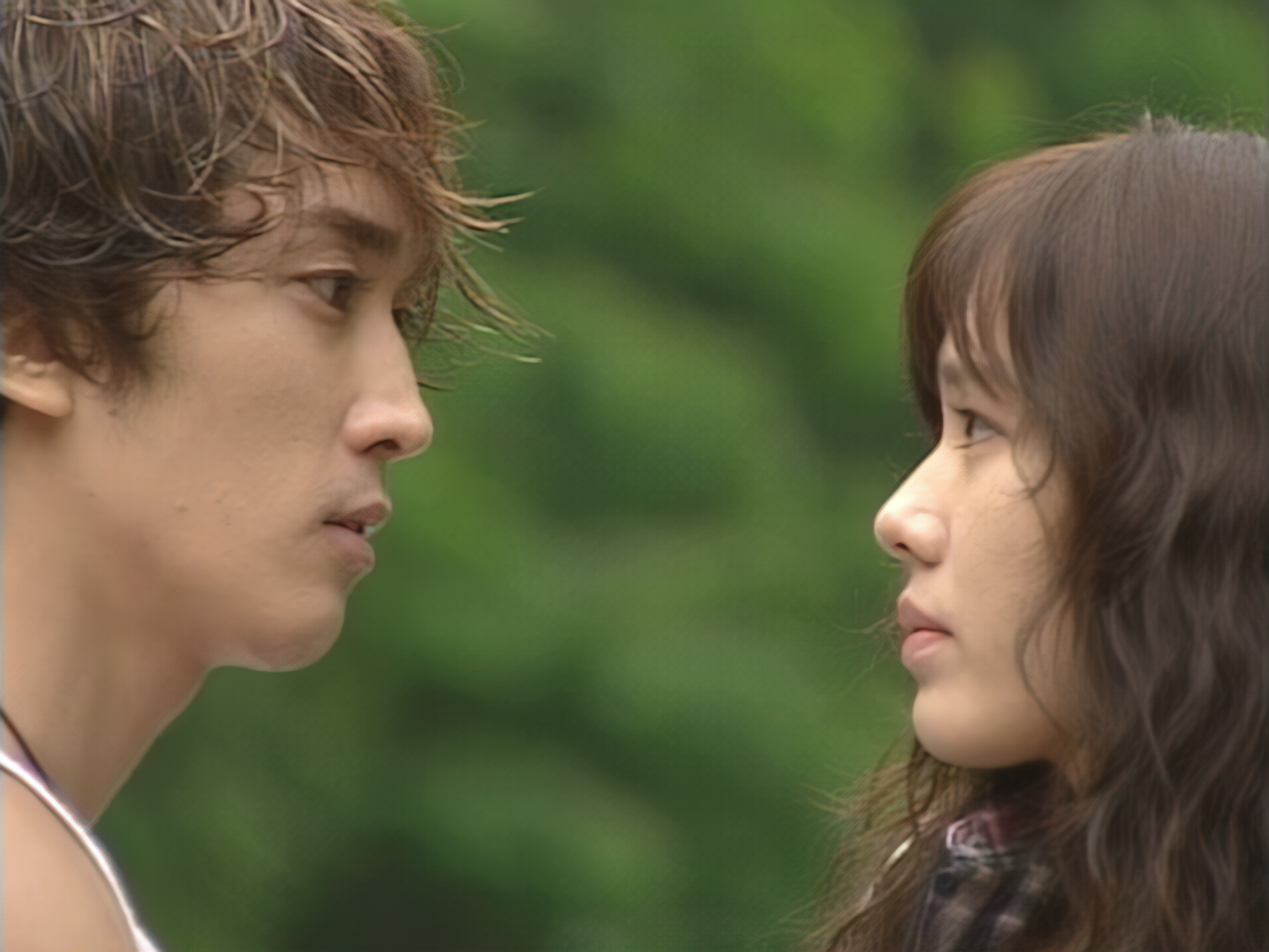

I’m noticing some grid looking thing with the Theia-Detail model (the setting I’m using is Sharpen 60, Details 100, Noise Reduction 5, the settings are not relevant as it happens on other values too).
Take a look at this picture and pay attention to the green background at the center, there are grid looking thing that’s apparent where color gradients are:
the originals video does not have this, anyone else seeing this too?

I’m seeing it too.
I have to keep sharpen under 30, and reduce noise to ~10-15. or less, to not have it appear. I can usually only push restore detail to ~60-65.
YMMV of course, and source material is a huge variable as well
