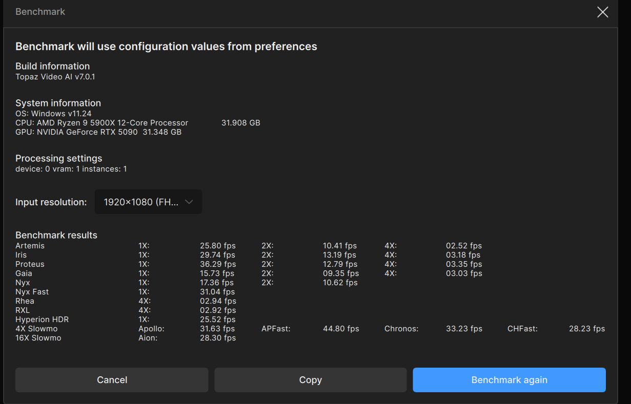

I bought the 5090 and I am seeing dismal render times, based on what I have been reading I strongly suspect my mother board is starving my GPU, as I only have a PCI E 3.0 board. I have a 4.0 board coming in as I write this. I did not want to upgrade my board to 5.0 because I would be spending over 1K for a new CPU plus memory..
for the new board you might also want to change the processor to 5950x or 5800X3D. I wonder which processor is better for Topaz, a faster one or one with more cores? Ida, don’t forget to post the results with the new motherboard here.
ddr4 is hurting you too.
you need to update that board/cpu.
or you’d be better off returning the 5090 and getting a 5080/4080 super and a zen 4/5 or even one of the intel boards - like the intel Ultra 7 Processor 265 - or even a 12th/13 gen intel and saving money.
the guy up there with the i5-12600k and the 8700g both outpacing the 5090 that costs double their system.
**I am actually surprised your performace is this low? Do you have good specs on your ram? expo enabled?
5800X3D would hurt TVAI performance with lower clock speeds. (It’s the best AM4 CPU for gaming but not for applications that don’t use the massive amount of cache it has)
I don’t think it’s PCIE. Your main problem is slow RAM imho. My 9 year old 6850K CPU + 3080 GPU system is faster in most of the 4X- and some of the 2X benchmarks because it has a quad channel RAM system. U can do a quick system check with userbenchmark.com

I performed an AI analysis of the results from three setups:
Parameter Old Xeon + 4070 Ti Ryzen 9 + 5090 Ti TR 7960X + 5090 Ti
Topaz Video AI Version v7.0.2 v7.0.1 v7.0.0
OS Windows v11 Build 27871 Windows v11.24 Windows v11.24
CPU Intel Xeon E5-1680 v2 @ 4.375 GHz AMD Ryzen 9 5900X AMD Ryzen Threadripper 7960X
Memory Quad 32GB DDR3-2400 CL10 Dual 32GB DDR4 ? Quad DDR5 192 GB ?
GPU NVIDIA GeForce RTX 4070 Ti 12 GB NVIDIA GeForce RTX 5090 Ti 32 GB NVIDIA GeForce RTX 5090 Ti 32 GB
Other PCIe Gen 3, ReBAR (Mod) Enabled 16GB PCIe Gen 3, ReBAR Enabled (?) PCIe Gen 5, ReBAR Enabled (?)

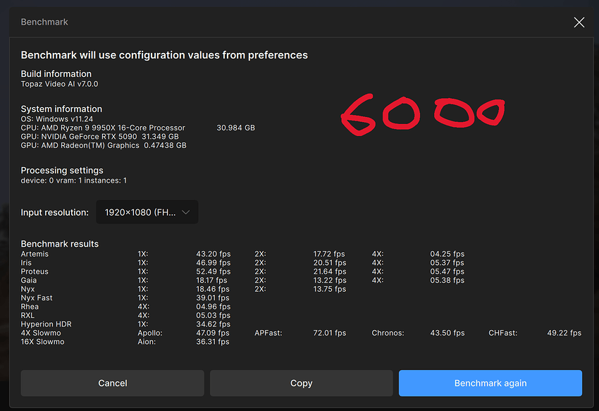

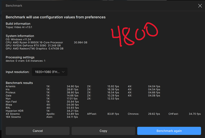

I just downclocked memory to 4800mhz on a 9950x and lost looks like ~20-25% performance compared to 6000mhz.
On Chronos, which I use a lot, I lost near 40%
Out of curiosity, could you test the performance of 6000 vs 4800 in AIDA64?
You can use the portable version: https://download2.aida64.com/aida64extreme765.zip
Probably for 6000 it will read around 75GB/s, which is less than on my Quad DDR3 2666 CL12.
This is what the DDR5 bandwidth should look like on the 9950X:

If you have such a big difference between 6000 and 4800, it may be worth installing 8000 modules in your system.
Interesting but not sure how u get over minus 40% performance in Chronos and CHFast from just a minus 25% downclock in RAM. As FirstEver said, AIDA performance numbers would be interesting.
Yeah I can do that, maybe tonight. I thought 8000 ram was no good on AM5 because the infinity fabric is locked at 3000. is that not true in all cases?
Yes, here is a good article testing it for gaming:
The reason DDR5-8000 isn’t always faster – or significantly faster – than DDR5-6000, despite a 33% increase in theoretical bandwidth, comes down to the frequency at which the integrated memory controller in the I/O die can operate. When running DDR5-6000, the memory clock is 3,000 MHz, and this can be matched by the UCLK (Unified Memory Controller Clock Frequency), which sets the speed for the memory controller. This allows the memory and controller to run in a 1:1 ratio at 3,000 MHz.
However, going beyond a DDR5 memory clock of 3,000 MHz forces the integrated memory controller to run at a 2:1 ratio, as it can’t exceed 3,000 MHz while maintaining stability – at least for the majority of silicon. So, when using DDR5-8000, which runs at 4,000 MHz, the memory controller defaults to a 2:1 ratio and operates at just 2,000 MHz – 33% lower than with DDR5-6000.
That said, the additional bandwidth offered by DDR5-8000 can sometimes overcome the penalty of the 2:1 ratio, resulting in better performance – assuming your AM5 motherboard is stable at that frequency.
