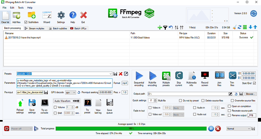

I use the ffmpeg batch converter GUI for some of my videos. I just had to replace ffmpeg.exe and the libraries in the program folder. But the newest version prints something about a library mismatch which makes that GUI crash when reloading the hardware decoder list, so I still use ffmpeg from VEAI 3.0.0.34a. This is how it looks like:
Different ffmpeg commands can also be saved and loaded on demand as presets.
If the official GUI had the option to decode, encode and scale with QSV, I’d use that one though, even though I’m not really sure if that helps so much speedwise with only a single job. The way I understood it is that the frames get transfered from NVDEC to RAM to VRAM (AI) to RAM for scaling and then back to VRAM for NVENC, so it would not be more efficient to let the eGPU do the work…
@suraj What is the -movflags frag_keyframe+empty_moov parameter for?

The movflags frag_keyframe+empty_moov are used to insert header information from time to time to ensure the output is readable if the program crashes or processing is stopped. It will be used later for implementing pause/resume and crash recovery.

If you don’t insist on doing it in Python, you could forge the FFMPEG Batch Converter which is open source:
It is capable of multi-processing and very customizable. It relies on Windows though unfortunately.
