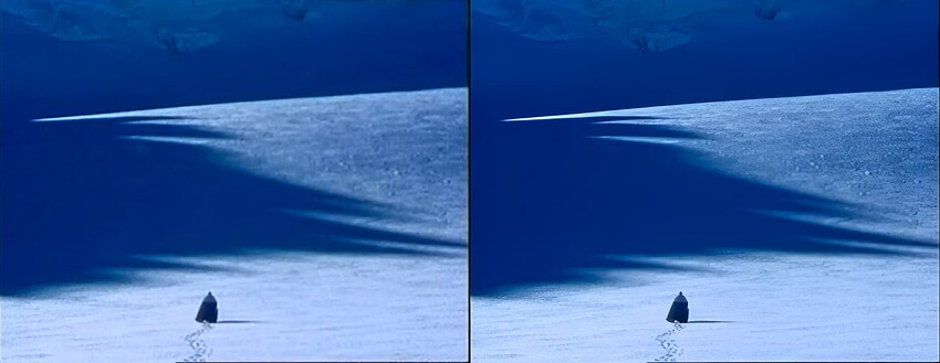

    -the same in the snow - looks a bit like a moon surface…

I found that using Rhea at 1x size without upscaling does still deliver a very good cleanup of the source with gaining some details but mostly leaving faces alone, so nearly no monster faces with that:
-not bad for the video being still at original SD size…
Even for that small low res face the original character is fully maintained at 1x resolution with Rhea (so here it’s behaving more like an Iris LQ / Proteus /Nyx crossover). But it does introduce jagged edges on sharp lines like the glasses - albeit only visible in such extreme zoom.
