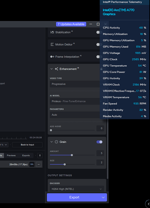

You can’t go by Task Manager - it doesn’t report A770 performance accurately - not exactly sure what it reports. Hit ALT + O and look at the rendering activity in Intel Arc Control. Mine is almost always at around 40% rendering utilization - but Task Manager reports 10-20%. if I’m interpolating using Chronos or Apollo, rendering is around 80% according to Arc Control.

Likewise, Intel Arc Control reports CPU utilization weird - very frustrating.
Unfortunately, Arc Control refuses to open for me when I have the iGPU enabled in my BIOS. I can pull up the overlay, but it’s doesn’t display any data. I even verified the primary GPU selected in my BIOS is PCIe instead of the iGPU, and it is. I wish I could use it as I’d like to be able to OC the A770 and access the better monitoring, but it’s just really poor software at the moment.

I’ve tried all the new versions, both of VEAI and Intel drivers, still crashing. I’m sticking with v3.1.8 and Intel drivers 4125, along with the replacement of the OpenVino - works great, but only 1 process at at time. I can queue them all up, but trying to do 2 or more crashes it too. Here I’m doing a upscale from 712x472 to 1920x1080 and getting about 17-18 fps.
