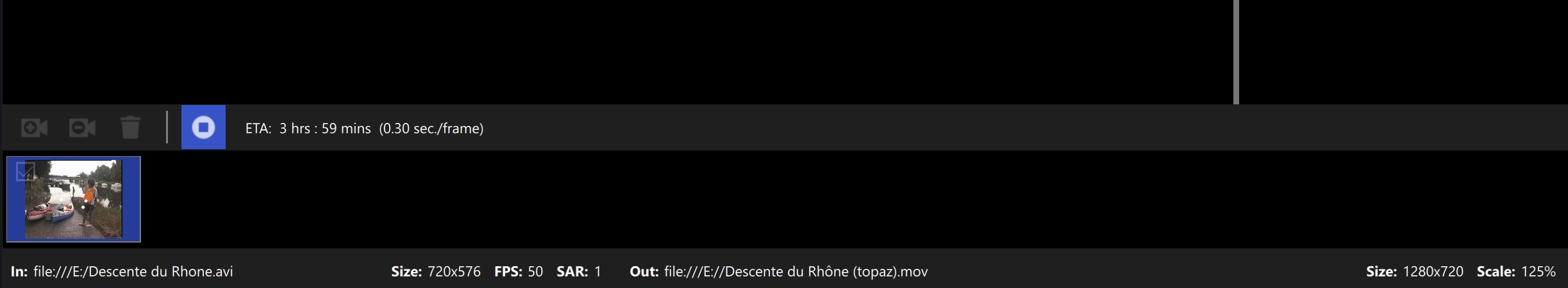

Hi, I have a ryzen 7 2700, a gtx 1660, 16 gb of ram, I have 0.30 sec / frames with Dione-DV from sd to hd. Do you find that reasonable?

Yes
I guess with a better gpu like the RTX3070 you could get 0.13 on the same task.
on my RTX3090 i get 0.08 spf on a similiar task
