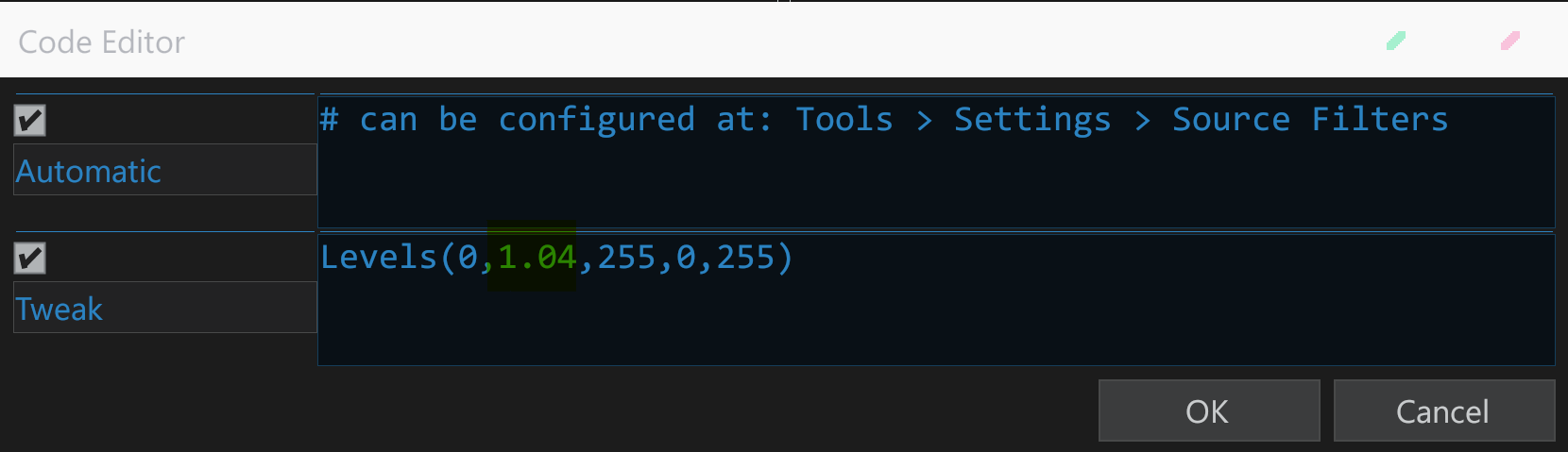

I also noticed while trying to compare different encoding presets that veai messes with the gamma value by changing it to -0.2. I haven’t tested with png/prores outputs though, so keep that in mind.
For whoever is interested in this method and would like to give crf 0 a try, you can my have my staxrip profiles with the gamma fix and my custom x265 settings included here - downscale profile*.

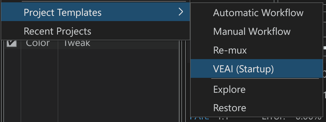

Extract, then drop the files in AppData\Roaming\StaxRip\Templates, granted you opened staxrip already for the appdata folder to be created.
Here’s how to load a custom template:

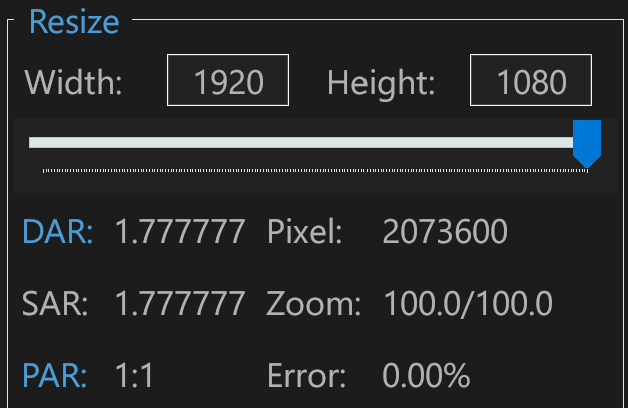

Chose your desired resolution via this setting:

Edit 3: Make sure to tweak the gamma levels when trying out different pass upscalings i.e.1.04 for two pass, 1.06 for 3 pass so on and so forth.
