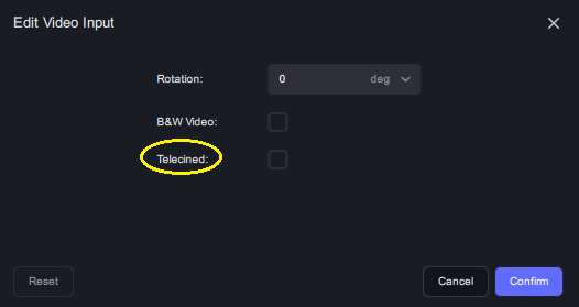

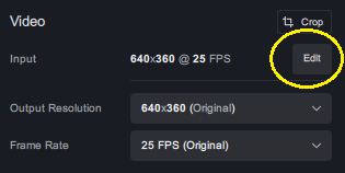

I thought TVAI has a built-in function to telecine the source. can he not use this instead?
