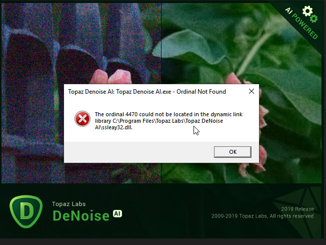

I read on the ON1 facebook page that many can use the Topaz Lab products from the send to application menu option in ON1. When I try, I get the error "The ordinal 4470 could not be located in the dynamic link library c:\windows\system32\ssleay32.dll. I then get the same error with ordinal 3906 three times, then the app loads. I get this with Ggapixel AI, Denoise AI, and Sharpen AI. The only one that works without error s Remask5. Any ideas?

Thank you for the input, I will do that until the problem is solved. I deleted ssleay32.dll from my Windows/system32 folder, so it now uses the one that comes with each product. (See photo above). Now I get just the error for 4470, no longer the three 3906 errors.
