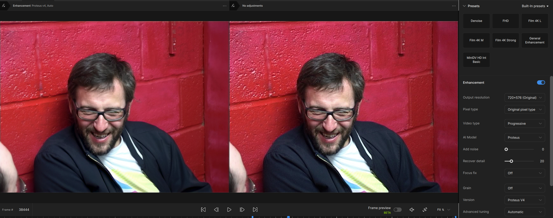

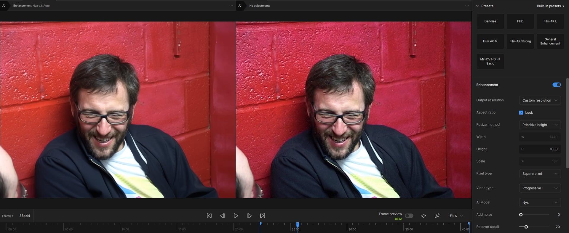

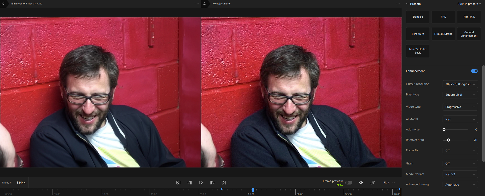

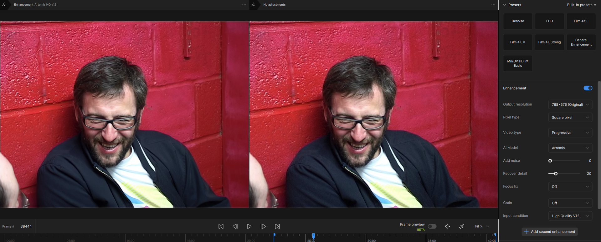

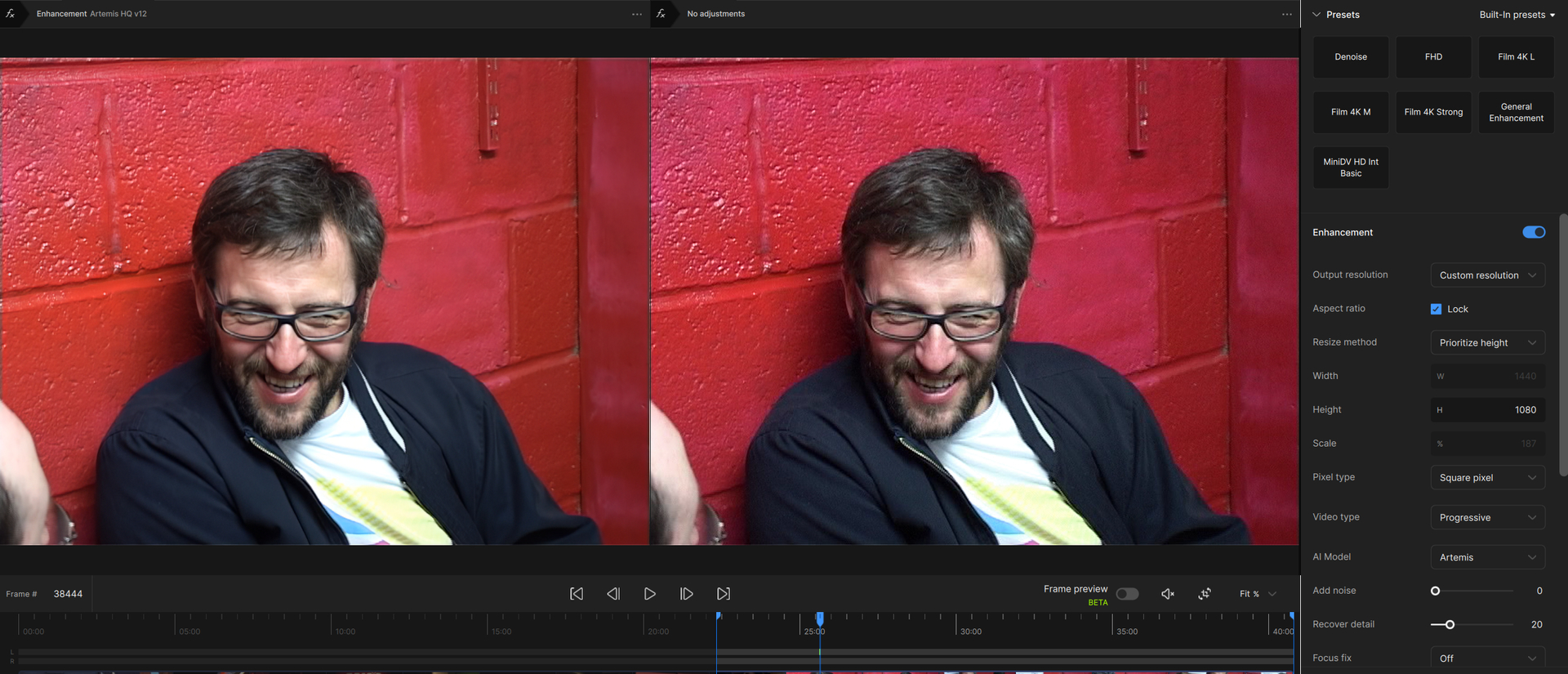

I’ve noticed that when upscaling SD video to HD, the colur palette changes slightly. Reds change to have an orange hue. But if the image stays at the original resolution, the original palette is retained.
It does the same using Proteus, Nyx and Artemis (haven’t tried it with the other models).
Here are some screenshots for your reference.
Is anyone else having the same issue? If so, how do I resolve it?
