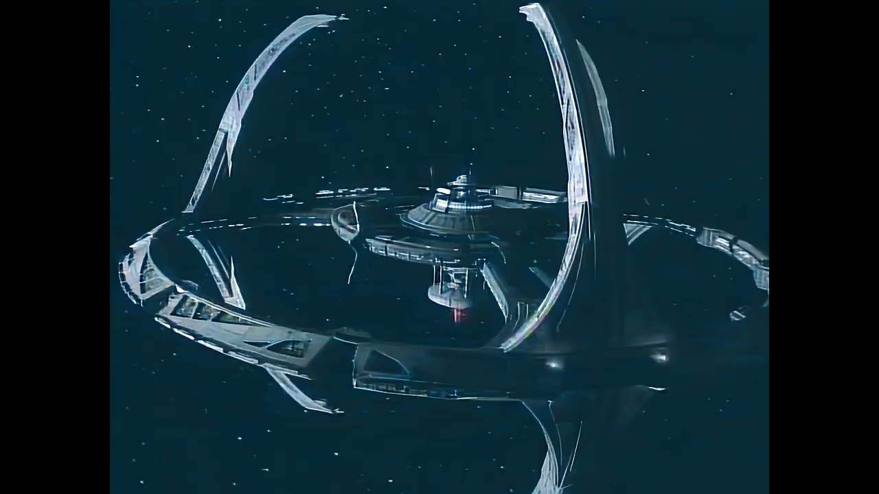

This is the opening credits (Season 1). These are a nightmare and I do not know how many variations I went through trying to balance clarity over artificial looks:

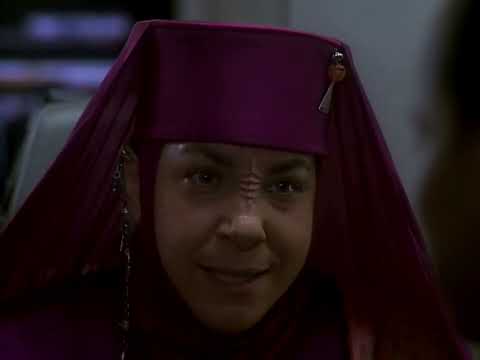

This is an extract clip where I had the same problem - retainment of detail, additional clarity but without delving into the plasticity look common with the denoising:
