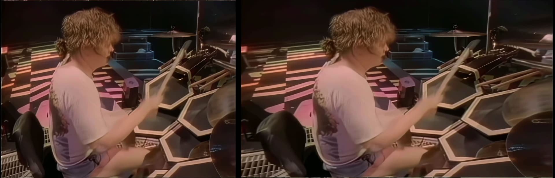

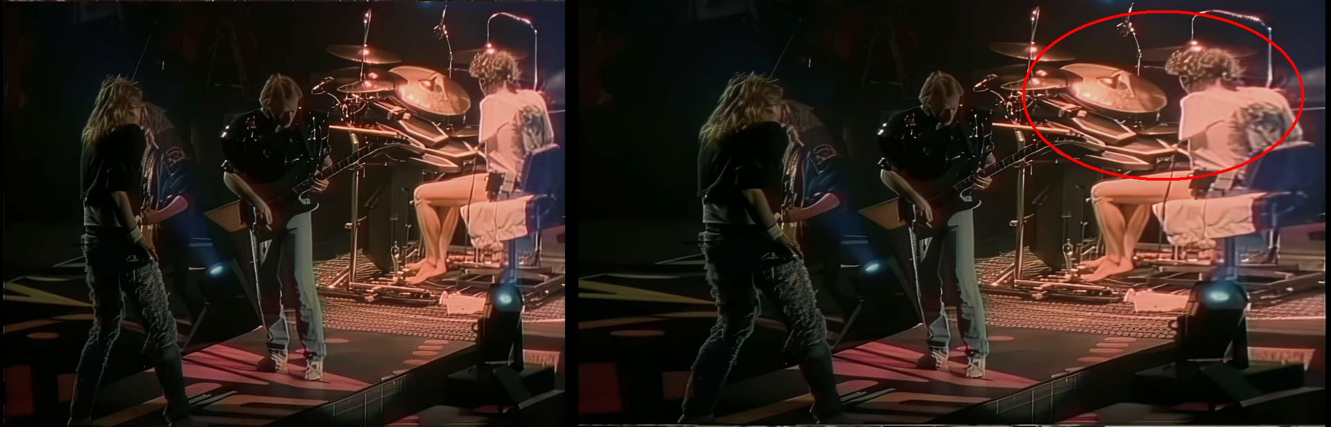

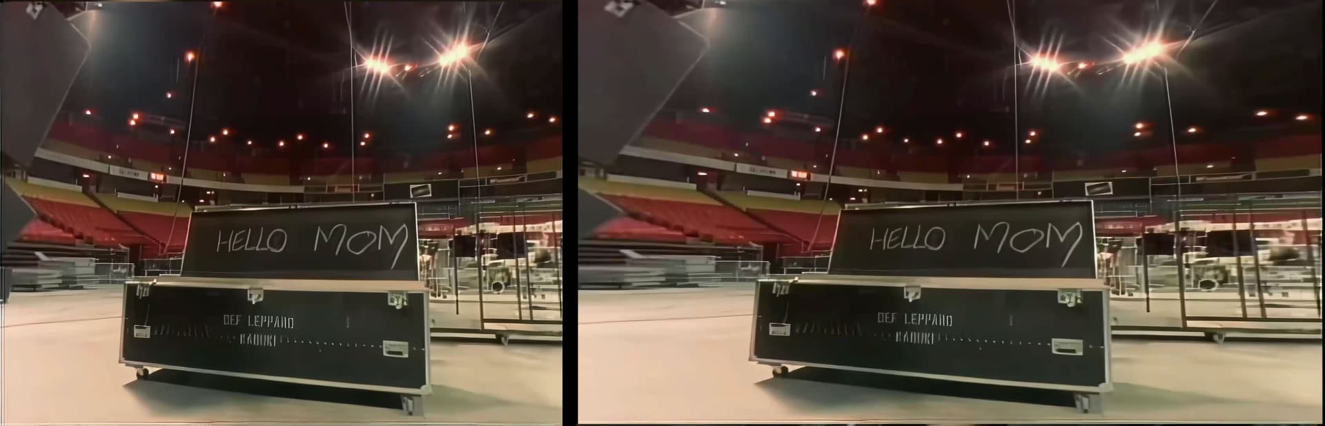

I would than mix the stretched version with scenes cut from the 4x3 in 16x9 all in 4k, I used filmora 11 for this.
As most of the view of the concert is centered there wasn’t too many scenes that needed swapping to the cut 16x9 version.

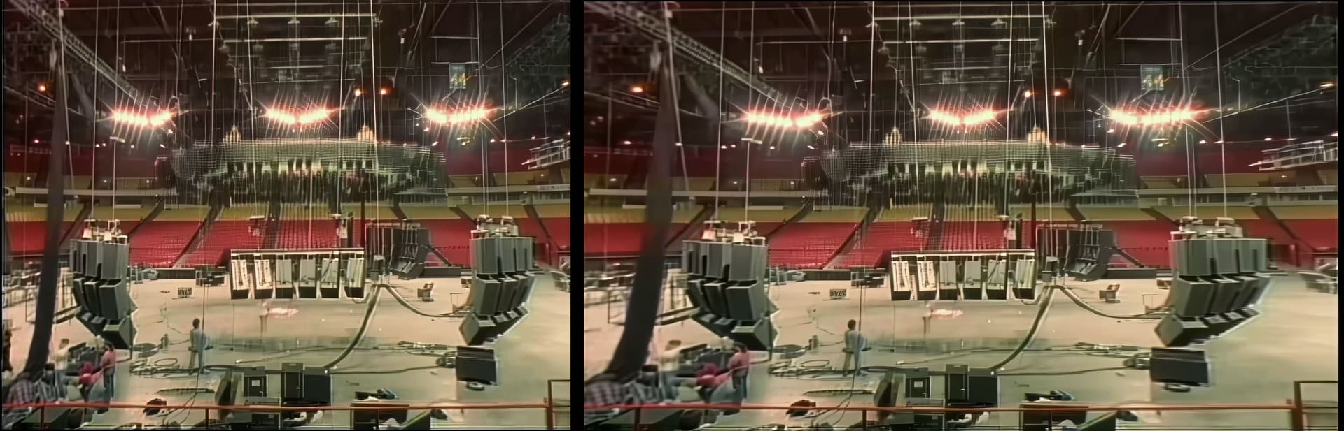

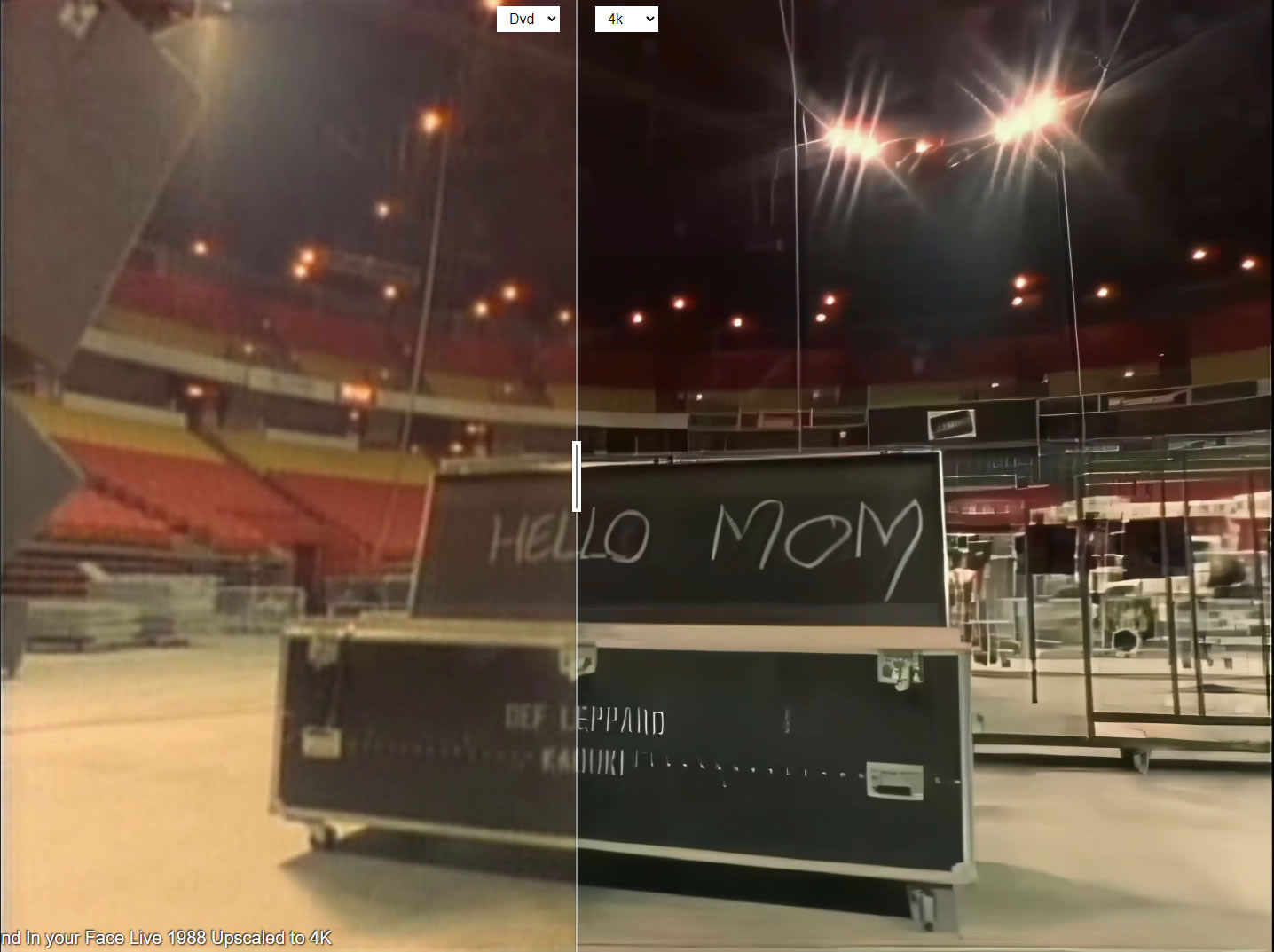

Also as you can see from the compare 4x3 shots the DVD had a kind of bronze yellow tint throughout the show , this might have been the intention back in 1988 but it wont do for 2022 .

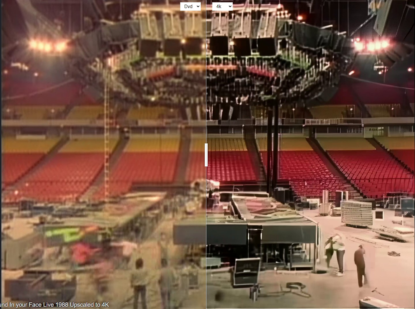

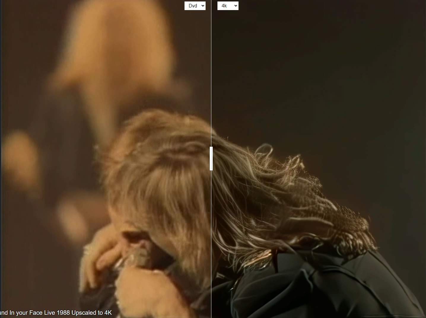

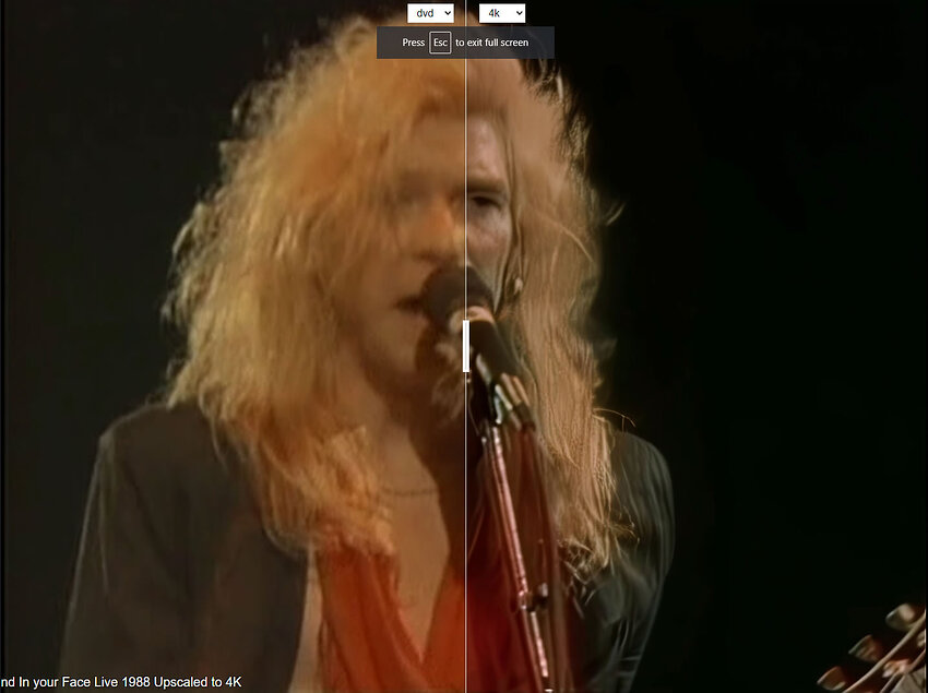

Than loaded in Topaz with Proteus fine tune first upscaling to HD than 4k

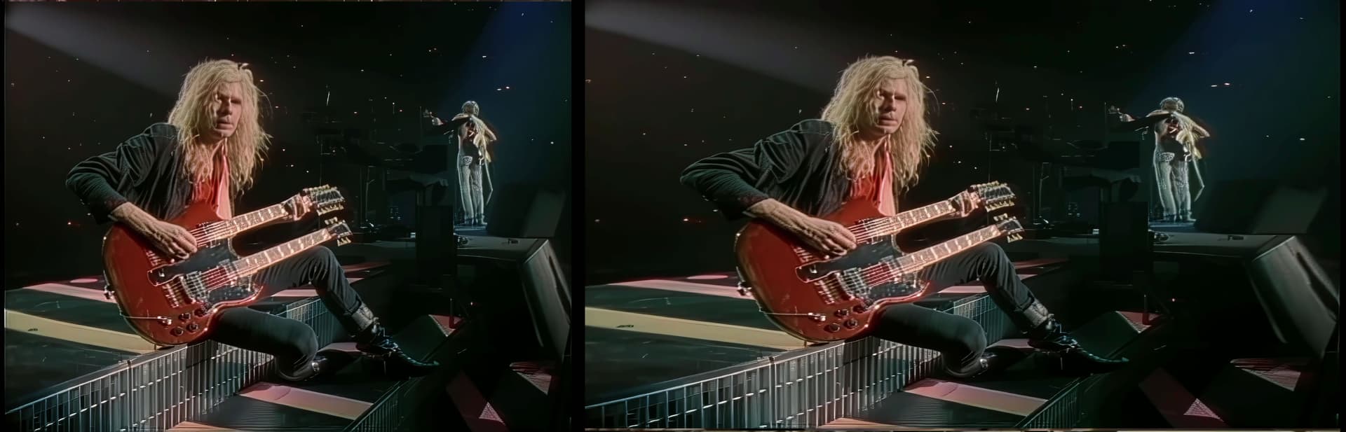

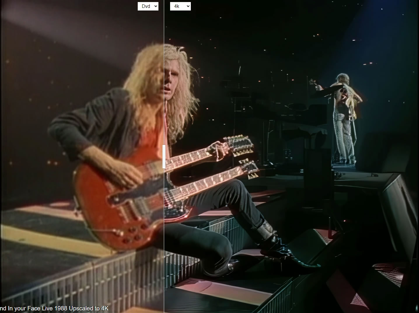

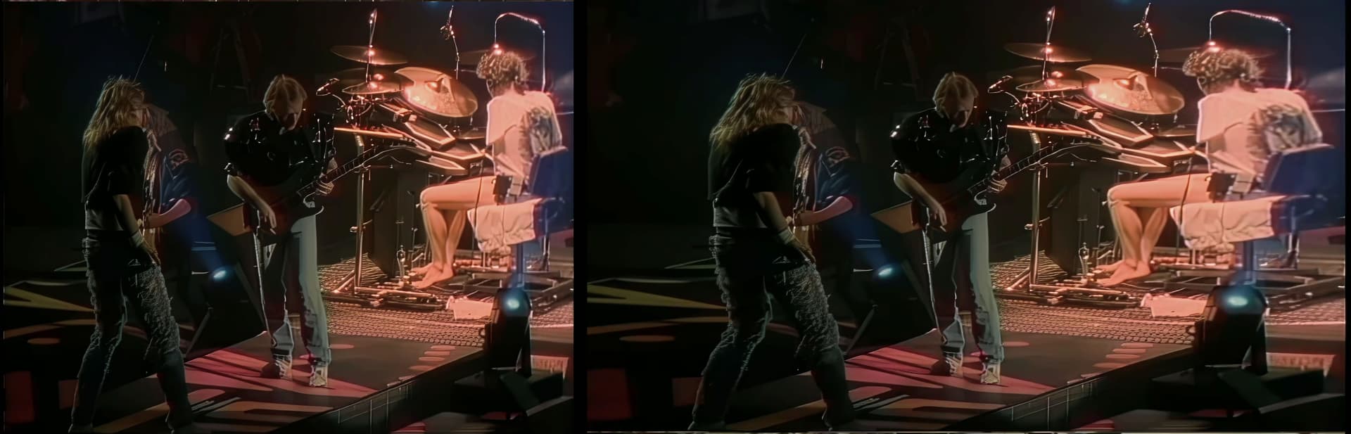

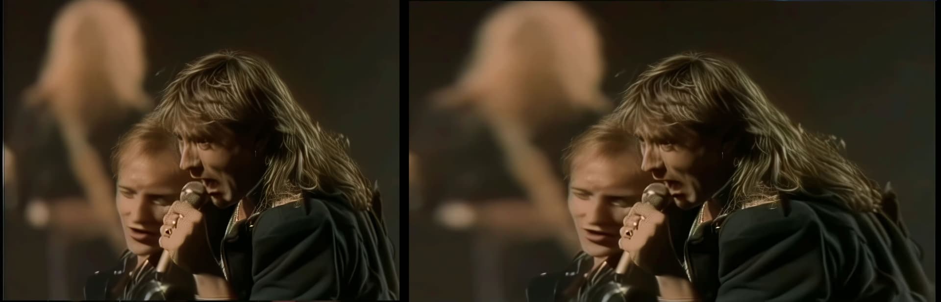

Some compare shots below
View these on imgsli and compare
some widescreen
