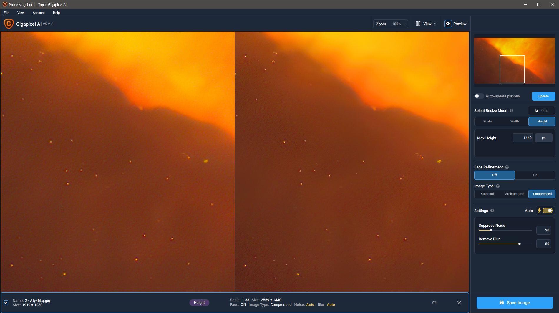

Ok I am back, I am having difficulty understanding what you are trying to achieve. So I took the image “2 - Aty46Lq.jpg” placed it in GigaPixel and upscaled it, using height’ to 2559 x 1440. Here is the settings I used and the preview:

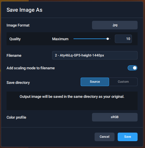

Here are the save options:

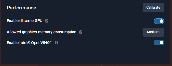

And here are my settings, Preferences, for processing:
