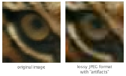

No, no, you don’t understand. We are not talking about dither effect or film grain that masks the banding, we are talking about something else, that happens to make it worse when using highly compressed methods with variable compression strength. What happens in YouTube is that to save storage and processing power, they try to use a method of compression where if something does not move in a frame it will look really good, almost not compressed. But as soon as you have a lot of movement between frames, it requires a higher bit rate, but instead of using constant bit rate or very high efficient codec, they use usually h.264 which gives decent quality or even good quality for any static shots, but completely destroy anything that moves., turning it into really nasty looking compression artifacts. Film grain moves all the time. Different for each frame. so it treats it as movement, leaving not film grain to be seen but instead this ugly compression artifacts. Some call them micro blocking.
Something like this.
jpeg-artifacts
JPEG-compressed-color-image-showing-blocking-artifacts-in-the-right-image-portion
You can’t really avoid it, since its on the youtube end. You can upload 1080p video as 4K maybe to try to get YouTube to use less harsh compression but its another compromise. Point is that , where normally you might use film grain to add on top of noise reduction in order to give back appearance of fine texture, when uploading so social media, its a dangers game, since film grain is treated as movement and compression becomes very visible. Therefore, ideally one would got rid of actual noise, but leave all the fine details avoiding adding film grain on top, and therefore avoiding noticeable compression artifacts as much as possible.
