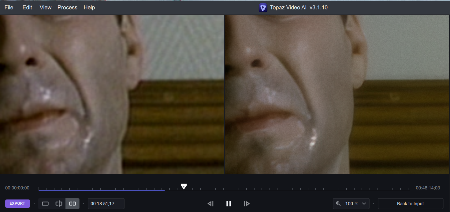

I have further tweaked the models some more and got great results (only 11 hours to go).
All settings as previously but then under
Enhancement
  • Video Type - Progressive
  • Ai Model - Artemis - Denoise/Sharpen
  • Input Video Condition - Strong Halo
  • Add Noise - 0
Here is a comparison 10 points if you can guess the actor.
