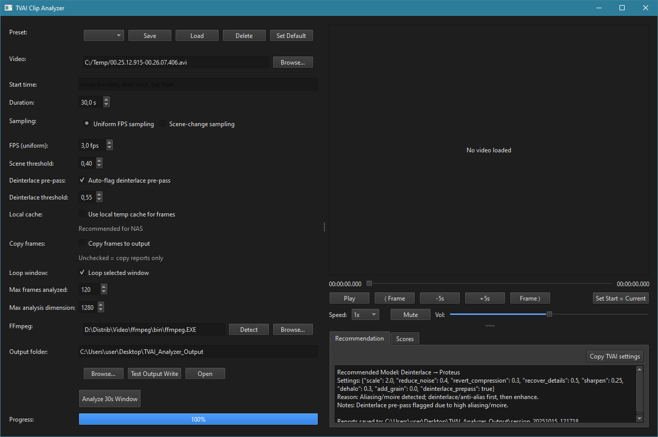

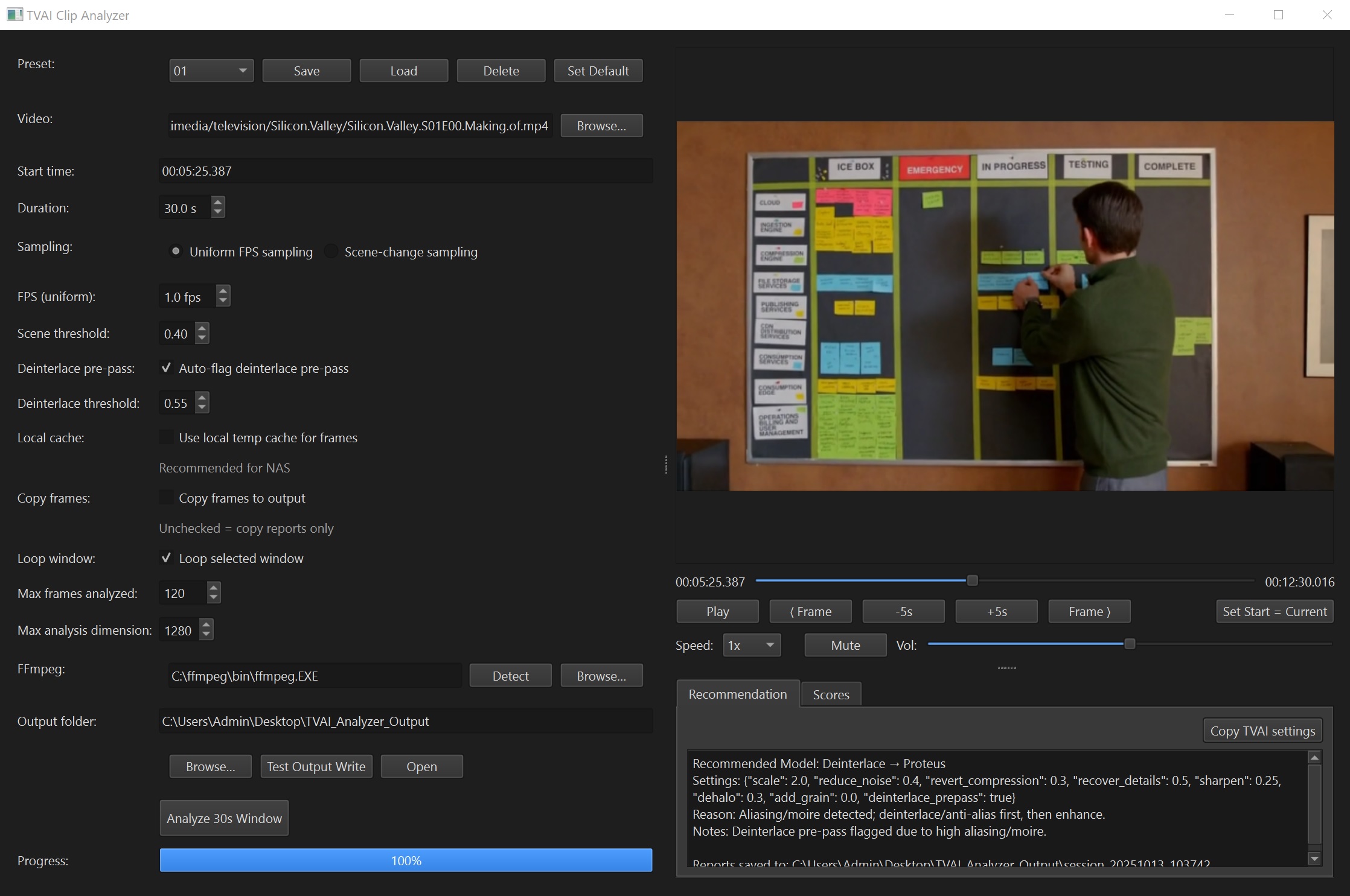

Hi,
I built a tool to analyze a video clip (default 30 second duration) and determine if it has problems such as aliasing, blur, banding, etc. It then recommends a TVAI model (v7) along with enhancement values.
Requirements:
  • Python 3.10+ 64-bit (tested on 3.12)
  • FFmpeg installed in PATH, ffprobe.exe is recommended
  • Python packages (pip install PySide6 numpy opencv-python pillow matplotlib); matplotlib can be skipped if you don’t want charts
Basic usage:
  • Browse to select a video file
  • Scrub in the timeline to the start of your sample clip
  • Click Set Start = Current
  • Review values in the left side pane, click Analyze 30s Window
  • Review Recommendation at bottom right, optionally copy to clipboard
I’m not a developer by any means. This was made with ChatGPT for my own use. I hope it helps some other users. You’re free to modify the script for your own needs, and/or extend the script’s functionality and republish non-commercially.
Thank you for your effort.
I have successfully tested it and got the results.
But player is unable to play video, nothing in the preview window:
Hi,
Thanks for testing. I built this mainly to work with h.264 MP4 and MKV files. It looks like you have an old AVI file. If you can determine the video codec, I think I can add support. It may tell you in the file properties, or you may need to do some investigation. I’ll work on adding general support for AVI this week.
https://superuser.com/questions/23512/how-do-i-find-the-codec-for-an-avi
It is indeed ADI DV codec. And there’s plenty of footage we have that require upscaling that stored in DV format.
