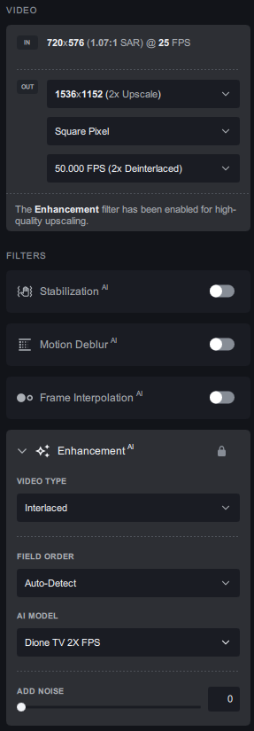

There have been many that asked how can they deinterlace the video in TVAI using Dione:DV, Dione:TV or Iris without doubling (bobbing) the frame rate.
By default if you select Interlace in TVAI it would automatically select x2 on the FPS. e.g. if your video is Interlaced 25fps, the output would become 50fps.
Even though most claim that it is a good practice to bob (double) the fps for motion smoothness it doesn’t come without its own issues.
for example: each frame has half the vertical resolution, or resolution equal to that of each field that the frame was made from. Bobbing prevents combing artifacts and maintains smooth motion but can cause a noticeable reduction in picture quality from the loss of vertical resolution and visual anomalies whereby stationary objects can appear to bob up and down (hence, the name “bobbing”) as the odd and even lines alternate.
Many requested how can they Deinterlace but keep the original fps without bobbing.
TVAI documentation sais that for one to keep the original fps, one must select manually the fps he/she wishes to have.
the problem with this method is that it requires you to turn on frame interpolation for this to actual work, if not it just won’t work and you would still have the double frame rate even though you selected “25fps” manually as in the example.

  1. load your video into TVAI and set all your settings for deinterlacing , upscale, whatever you want, as you Ready to press the “Export” button.
Example:
