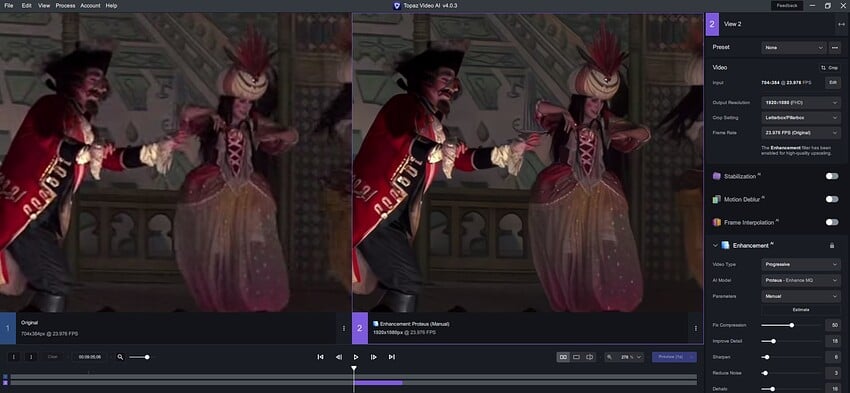

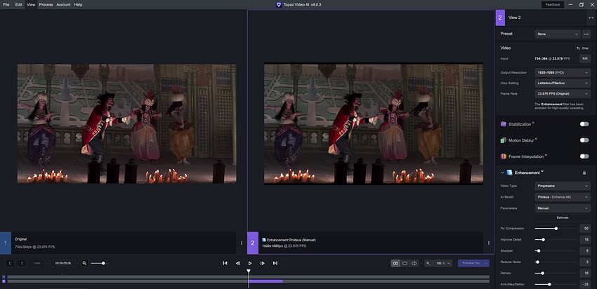

Something is wrong with the preview scale.
100% is not output but input 100% scale.
As you can see I upscale to 1920x1080 and the real 100% is at the second screenshot, about 278%
