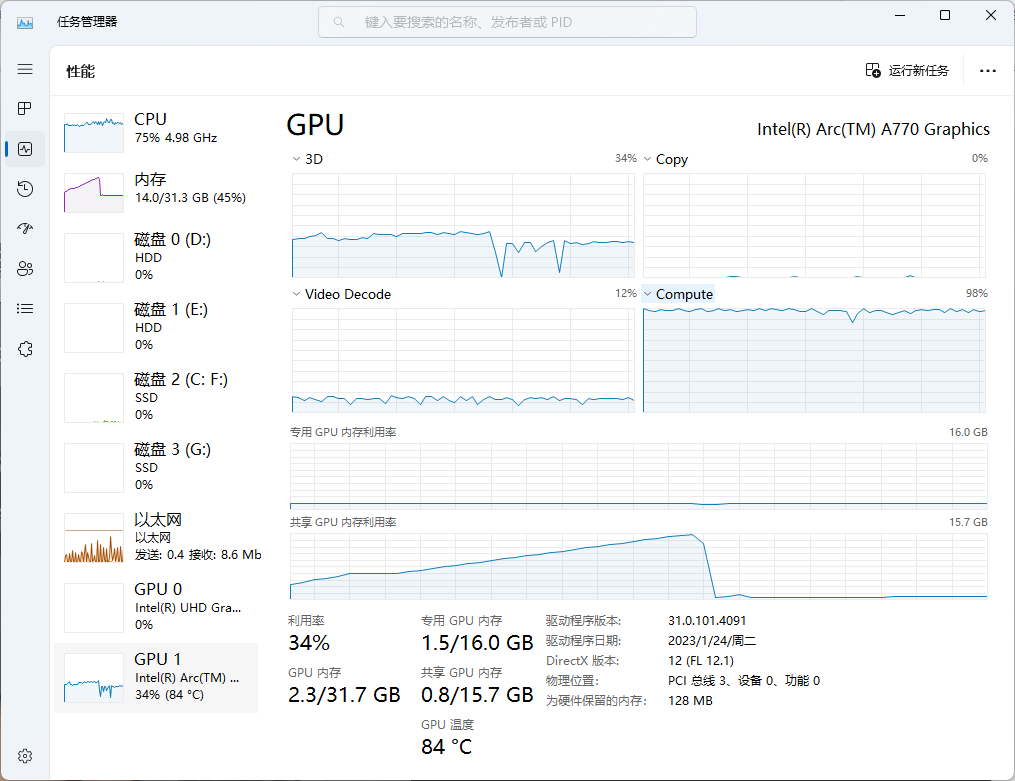

Shared memory after fill, software UI unresponsive, click no response.
ę— ę ‡é¢˜
13700K,A770
windows11 22h2(10.0.22621.1413)
gpu driver ver:101.4091
All previous versions had this problem.
the pipe gets stuck in the process.
Pipe from the latest 32-bit ffmpeg (avisynth script processing) to topaz 6-th ffmpeg.
