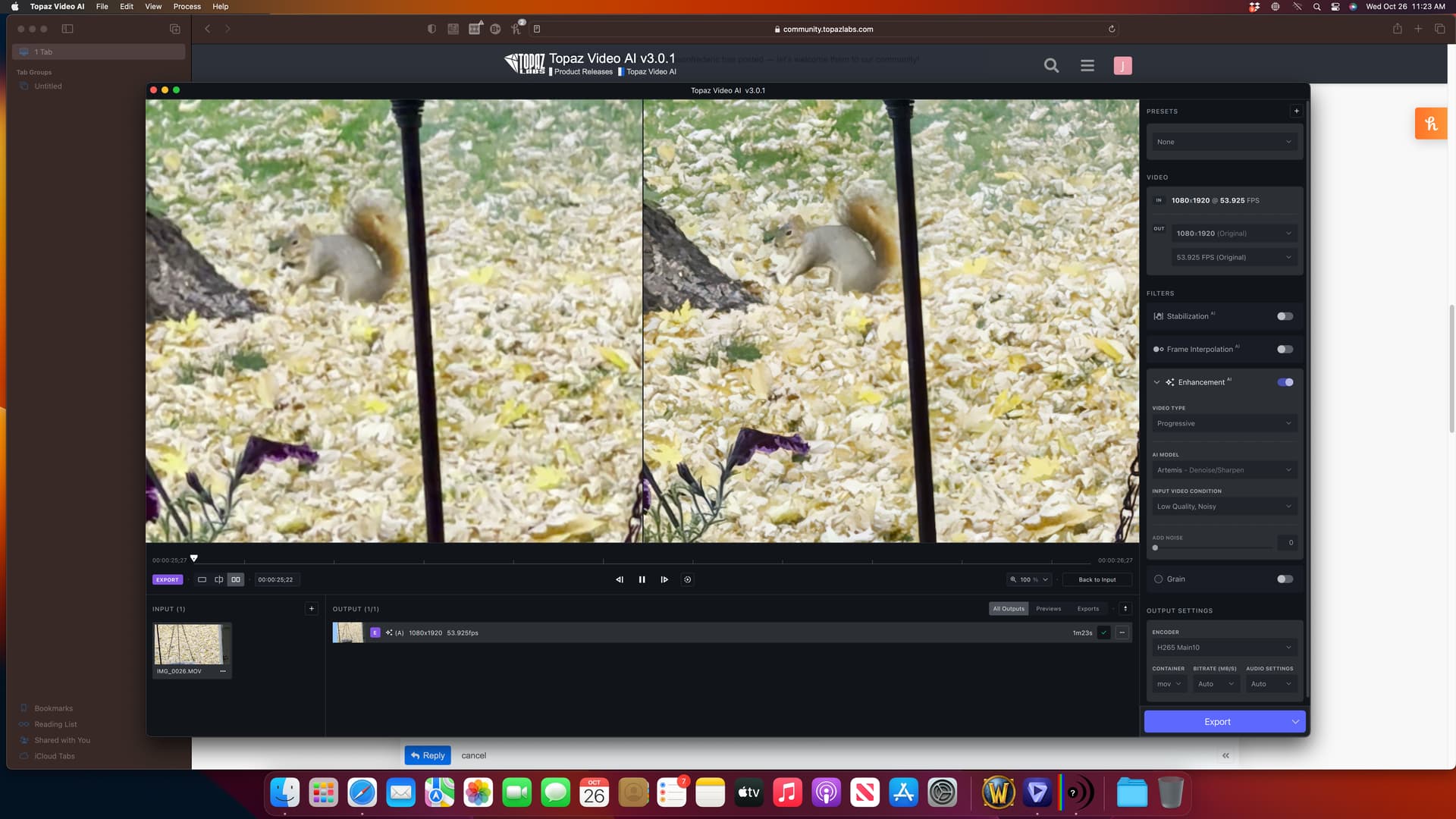

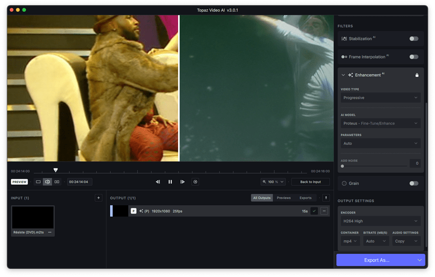

I still have this split view issue when previewing: the left image is stuck.
If you want to test, the “RĂ©siste (DVD).m2ts” file is already in your Dropbox folder.

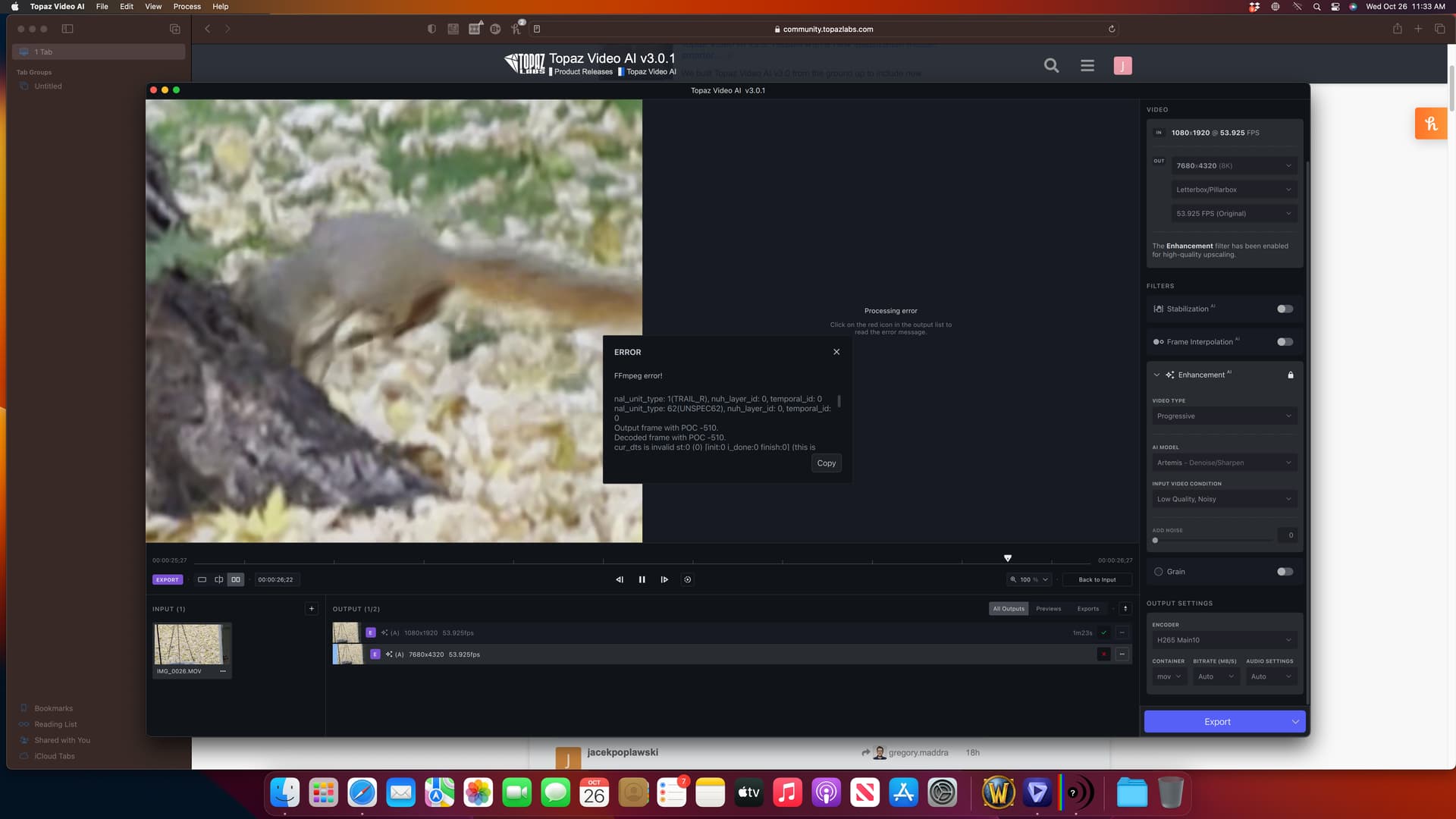

Error When Choosing to Enlarge to 8 K:
nal_unit_type: 1(TRAIL_R), nuh_layer_id: 0, temporal_id: 0
nal_unit_type: 62(UNSPEC62), nuh_layer_id: 0, temporal_id: 0
Output frame with POC -510.
Decoded frame with POC -510.
cur_dts is invalid st:0 (0) [init:0 i_done:0 finish:0] (this is harmless if it occurs once at the start per stream)
Output frame with POC -508.
Decoded frame with POC -504.
Decoded frame with POC -506.
Finished processing frame alq-13 0 0.008333 0.008333
w:4320 h:7680 fmt:bgr48le sar:0/1 → w:2430 h:4320 fmt:p010le sar:0/1 flags:0x200
Error encoding frame: -12902
popping: -542398533
Error initializing output stream 0:0 – Error while opening encoder for output stream #0:0 - maybe incorrect parameters such as bit_rate, rate, width or height
Uninit called for alq-13 0
Statistics: 0 bytes written, 0 seeks, 0 writeouts
Qavg: 243.692
2 frames left in the queue on closing
Statistics: 2231012 bytes read, 55 seeks
2022-10-26-11-08-19-Main.tzlog (300.2 KB)

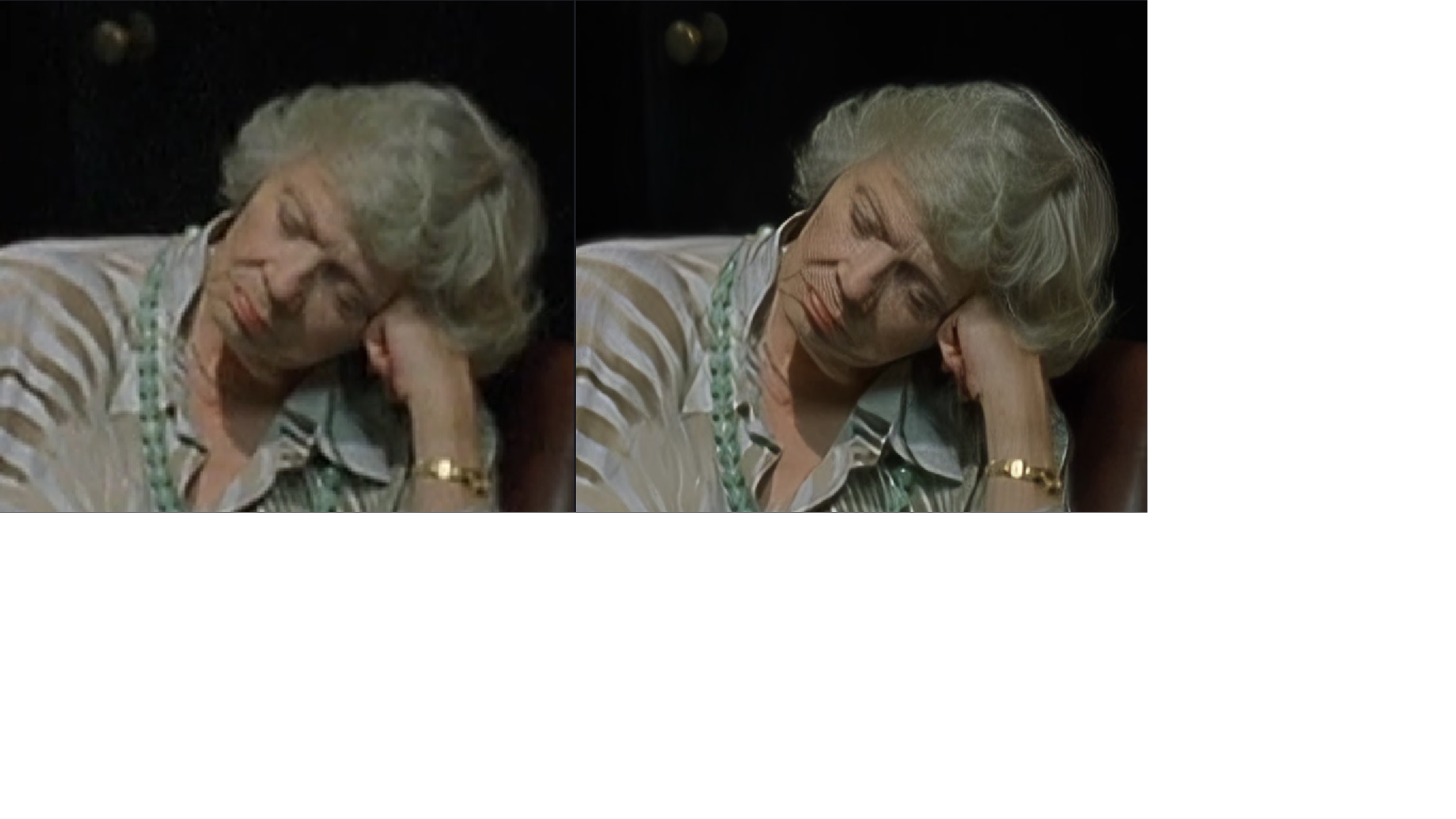

Those are caused by “Recover Detail” and “Sharpen”.
As before, I’d advise to turn those to 0, switch the parameters to manual.
Since these artifacts are “only” with some “detailed” faces, but not with other detailed objects, I think that is matter of better training of AI models handling faces. Recover Detail and Sharpen set to 0 will get iron smoth across every thing. That’s not the best compromise.
Ols male faces are ok.
Yes, this is complex. If you are exporting a file (you must declare it an export before starting and it will show up in the lists when you click on the “Exports” button) it will be located in your “Export as” file folder with the suffix _number_tvai as an mp4 file. If the file is a preview, it will be in a special internal folder and will show up if you click on the “previews” button. You can clear the previews by selecting “File → close all sources” (I currently do not have any previews. I think there are separate options if I have previews). You can control these from the File dropdown. You can see / set the default directories in the File → Preferences → Directories options.
Wow! I’m not the only one. I saw the exact same old lady wrinkles on Janeway’s face in Voyager S01E01. I closed it up, shut it down and walked away shaking my head. And that was after a 24 hour upscale. My free upgrades end in two weeks, and I’m wondering if its worth it or not.
