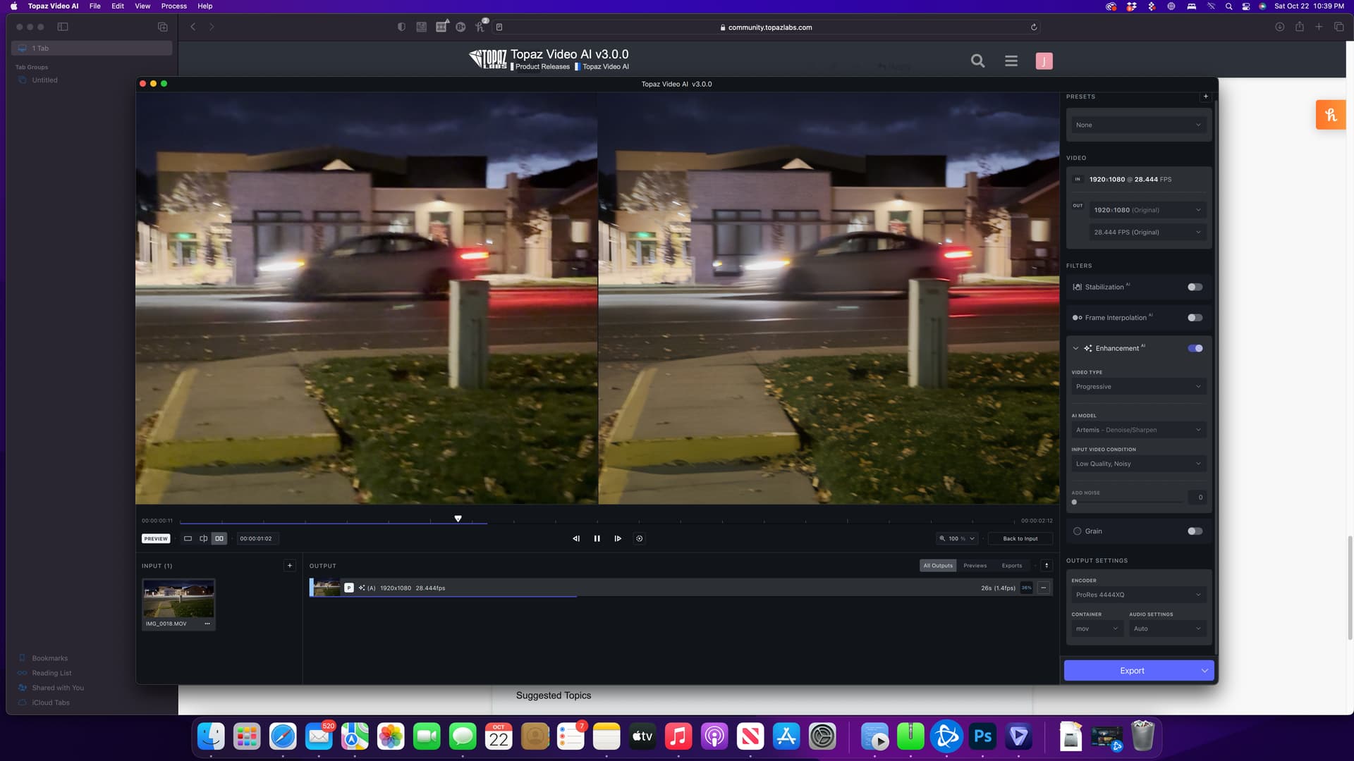

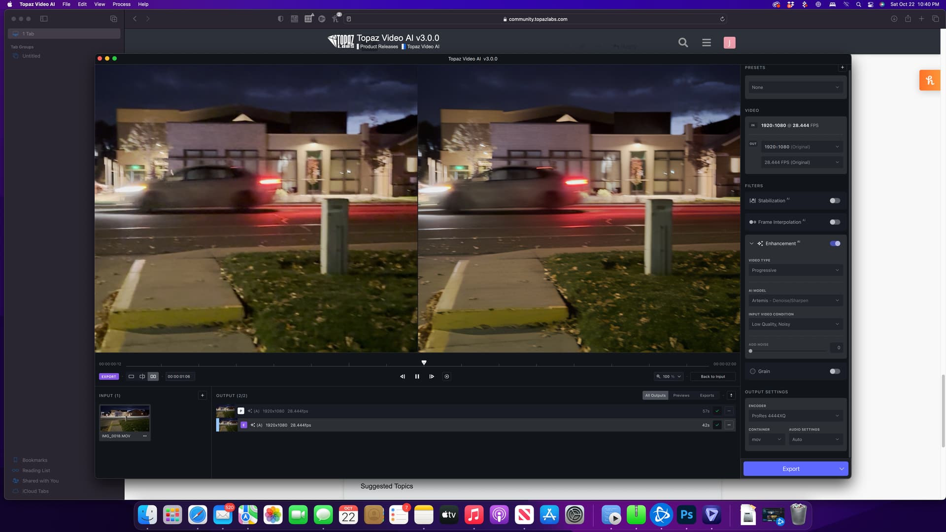

@gregory.maddra Can not see Much Difference.
Look at the car :slight_smile:
Do we have Hdr Support yet ?
Look at everything else!
What Screen Shot you look at?
I see no difference…

It is hard to look at any details, when images uploaded to this forum are showing compression artifacts.
I’m curious what is up with the odd input frame rate of 28.444?
What is causing that?
Your screenshots are terrible. We don’t need to see your entire desktop. Can you not maximize Video AI and then capture the entire screen?
And most of the time nobody here has any clue what you are trying to point out about the images.
