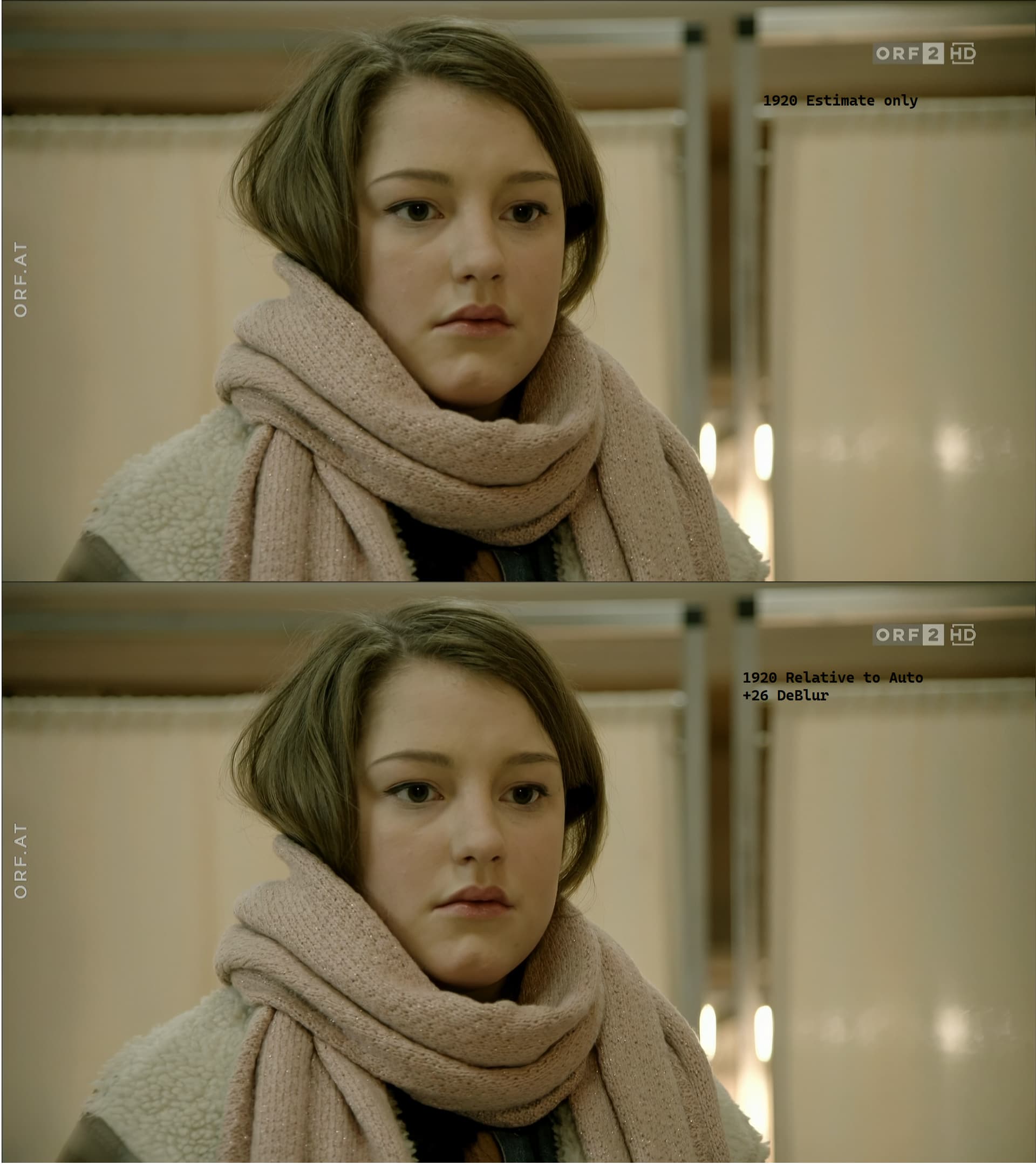

What does Proteus show for this frame when you Estimate the values. That would guide what the sliders need to be set to. Every video will be a bit different unless you know the source material. How bad is the frame with just using Auto?
We just need someone in here named LMAO now.
I downloaded a video from the site you mentioned. The video was 1280x720 @ 3000Kb/s.
This screen shot probably won’t do the images justice but here is what I got.
Hopefully this will be better.
