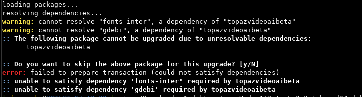

Anybody had any luck installing it on Arch?
Proceeded via debtap, but cannot satisfy fonts-inter and gdebi
there’s a nerd-fonts-interon the AUR, and think should solve it, but no gdebi
An Appimage would be mostly welcomed, or flatpak instead of a deb^^

I run it on arch all the time, but I just extract the data.xz and control.xz archives inside the deb using Ark and drop their contents in place. Never had to worry about dependencies, really. I need to use LD_LIBRARY_PATH to point it at the CUDA install, and also the bin and lib folders for Topaz itself, but it runs after that without major pain.

It is indeed working just as you suggested, plus passing the bin and lib paths as the location of the dynamic dependencies!
Would also add that the login via browser worked, and GPU encoding (nvidia open kernel drivers - 3070) is also working without pointing to the CUDA install ^^
