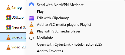

MediaInfo is a great program that shows you video and audio file information. You need that information to get people to help you here
.MediaInfo
Thank you. But I am not sure why I need MediaInfo ? And also not sure how to use it.

If you really want help you need to provide details about your video files. MediaInfo does that. You download and install it. For Windows you can then right click on any file, select MediaInfo, and look a the details of any media file. You can copy that information and paste it into a topic post or email.

MediaInfo as @Mike.M mentioned in his following post, is a great tool that provides you detail information about your video file. this tool will serve you very well not only for Topaz but for many other things you might need a bit more information about the video then just a simple info such as bitrate and scale.
the tool could be downloaded Here and/or it comes built-in as part of K-Lite Codec Pack Mega (it is a codec pack that your computer needs if you want to encode/playback videos using a variety of cedecs, very useful pack to have).
once installed it is automatically imbedded as part of your explorer shell and all you need to do is right click on a video/audio file and select MediaInfo
