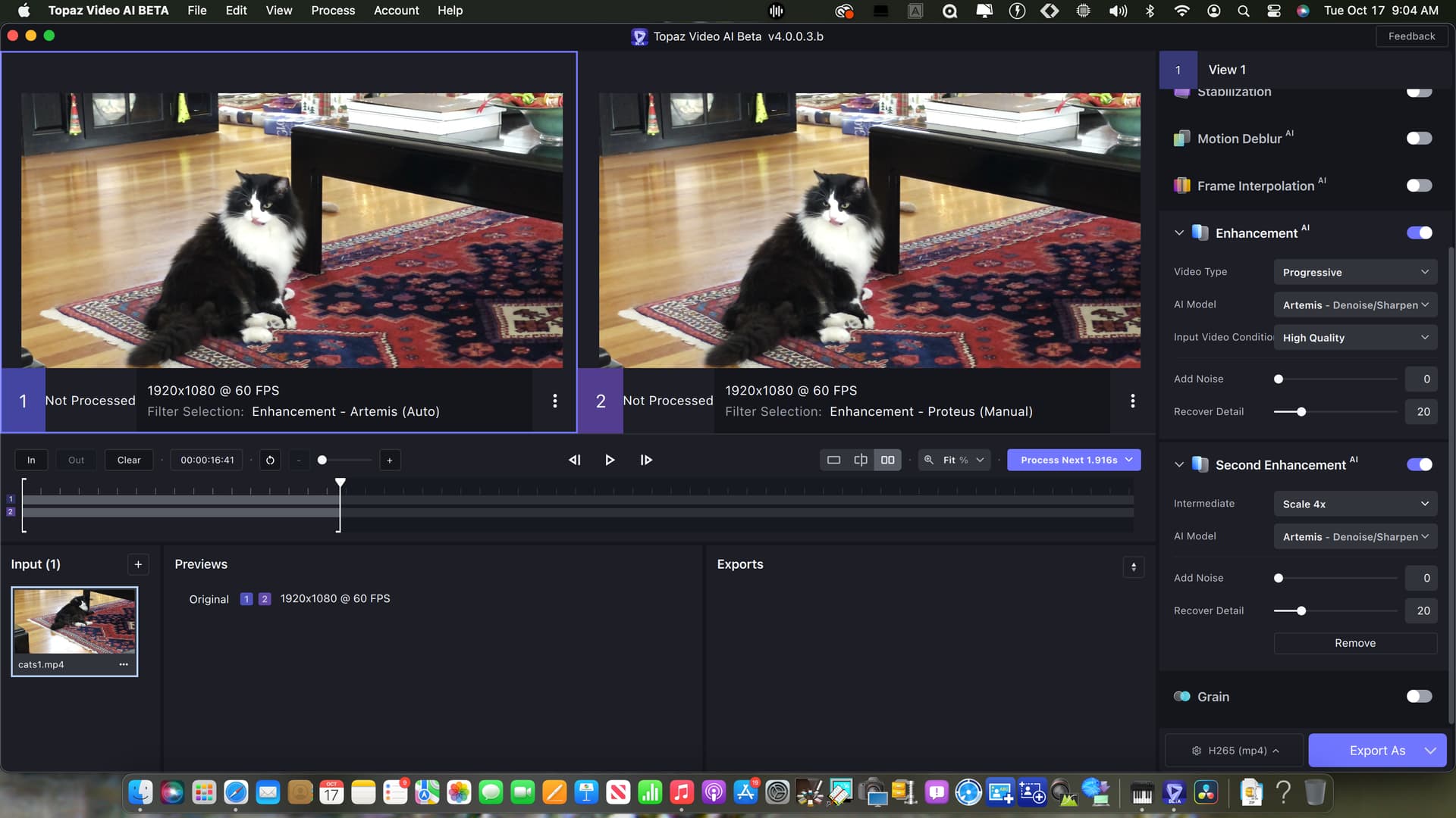

The first difference is you must select which view to focus. If you click the left view, A will be highlighted. If you select the right view, B will be highlighted.
When you have a view highlighted, the models/filters you add to the view will be specific for that view. So if you want to see how “Recover Original Detail” works you could give view A & B Enhancement, then give them different “Recover Original Detail” values.
When you have made the changes to the filters you want to see, you can click “Process Next
” to see these two different combinations of filters applied to the input.
When you do this, a progress bar will be applied to the timeline. This is the area of the video where you chose to see the filters be applied. You can watch this section to see how the input has changed. At any time, you may right click a view and click “Reset to Original.”

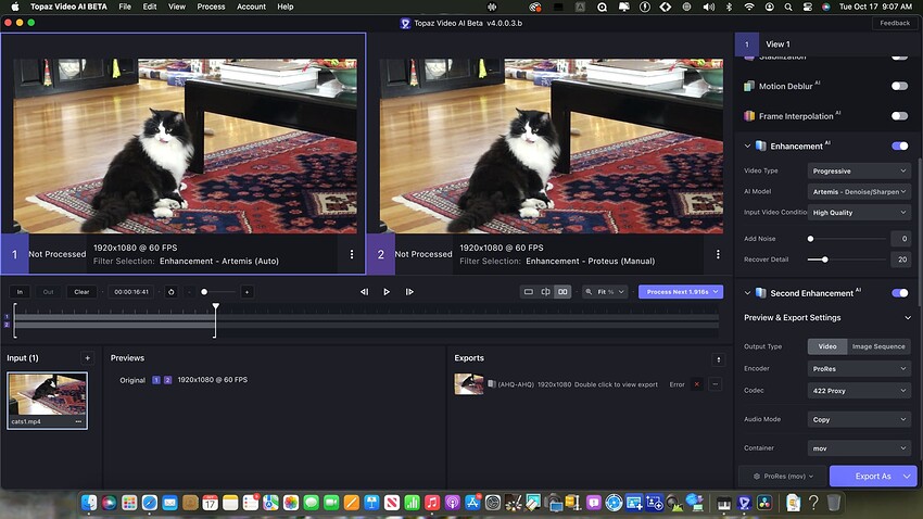

In the “single” preview mode, there doesn’t appear to be an option to pick “View 1” to adjust it’s settings.
When processing a preview, there is no: FPS, time completed, time spent process, etc.
Once again, things like performance is important for figuring out which model you want to use.
In the “Previews” section at the bottom of the app, I clicked on the three dots and the only option is “Close All”. There’s not “Show in Explorer”, “ffmpeg command”, etc options.
The “Close All” button in the previews section at the bottom only seems to close the selected preview, not all the previews.
In the “Previews” section at the bottom, a bunch of useful information about the previews are missing (E.G. FPS, whether or not they completed, time to complete, etc)
Cropping doesn’t work in the previews. All the previews are “full sized”.

Sometimes my model settings aren’t applied correctly. I don’t know what causes it.
Example of issue.
  1. Import a video. Both side 1 and 2 are original.
  2. Select Side 1, set to Iris.
  3. Select Side 2, set to Nyx.
  4. Press “Process videos”, both Side 1 and Side 2 are Nyx.
The “Only Keep One Preview” option breaks the side by side preview system. Because only one of the previews is actually generated.
In the “Input” section, you can click on the “Three dots” and it will have options for “Copy Settings” and “Paste Settings”. This will copy and paste the enhancement settings from the selected side. This doesn’t really make sense. This is the original video, it shouldn’t have enhancement settings.
