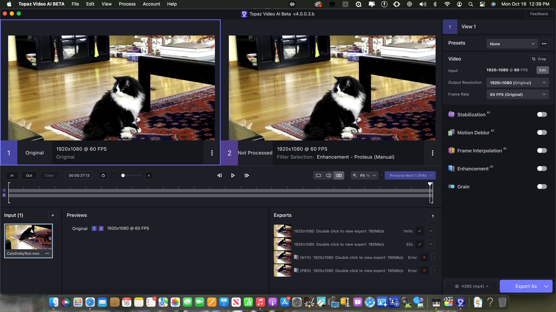

Split preview is greyed out and can’t be selected in the main UI. It can be selected in preferences.
If you enable the Split preview mode in the UI, then import a video, it will use the Split preview mode. But you can’t drag the middle bar in split mode.
While in Split or Single preview mode, there doesn’t appear to be a way to select preview 1 to adjust it’s settings.
The little bar below the previews doesn’t tell me which enhancment filter I’m using. E.G. If I select Gaia, it just says “Enhancement (Auto)”. If I select Iris it says “Enhancement (Auto)”
When generating a preview, there isn’t much useful information (FPS, time spent processing, time left, etc are all missing).
When playing the preview, once you reach the end of the preview period, the preview will switch back to the original video and just keep on playing. Ideally it should pause, or loop back to the beginning.
In Side by Side preview mode, sometimes the Save Settings button doesn’t work properly.

Cropping doesn’t work in the preview system. E.G. You crop a video, then process the next 5 seconds, and the video generated from that isn’t cropped.
Sometimes the preview doesn’t show. I don’t know what caused this.

  1. macOS 13.6 — Save dialog unable to use arrow keys in title field as it moves the player head
  2. can you display the fps/spf and the time when processing a preview
I have reported #1 to Apple, this has been happening since Sonoma, the same happens with other apps, e.g. AVIdemux has the same issue with the save dialog. Hopefully Topaz can find a workaround and/or also report this to Apple so they fix that behavior in the O/S. Thanks for reporting in this forum!

#1. When I go to process a preview, there still is nothing in the exports window.
#2. There is still no way to stop processing once started. Closing the app DOES close out FFMPEG on the backend now.
#3. When playing a processed preview, the first run works without issue, but after it loops both A & B switch to original video and B shows Not Processed.
I really like the zoom timeline feature and it is working great. The playback is still nice and smooth as is the scrolling on the timeline. Super progress on a lot of these things being reported. Are you going to be adding the ability to add more panels (C & D & E etc)? What would you think about having a dynamic timeline show up to scroll through processed previews? It would be nice to be able to scroll forward and backwards on a processed video (or multiples) and zoom in on it to look at frame by frame and the like.
I am still not sure what In and Out are for, so 100% agree with others to have a how-to video for the features and how to use them.
