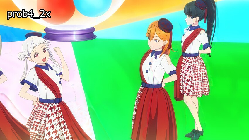

Proteus v4 4x upscale still looks quite bloby, especially in scenes with compression artifacts and high detail. E.G. A scene containing plants swaying in the wind.
Proteus v4 2x and 1x show similar blobiness. But this is probably excepted since they haven’t been fully trained.
Note: Full auto settings was used.

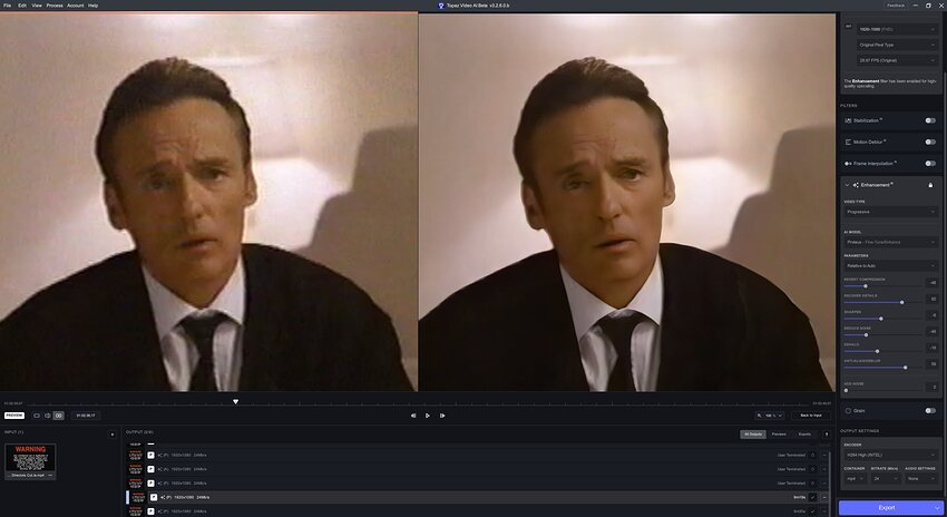

Proteus v4 - 4x upscale (Original left, upscaled right):
Proteus v3 - 4x upscale (Original left, upscaled right):
The video I’m working with is low quality, and I am zooming in quite a lot (Using the 100% viewing option in TVAI, which is 400% on the original footage). But you can see, Proteus v3 seems to be taking the detail that does exist in the original footage and is enhancing and upscaling it. Proteus v4 is taking that detail and turning it into blobs

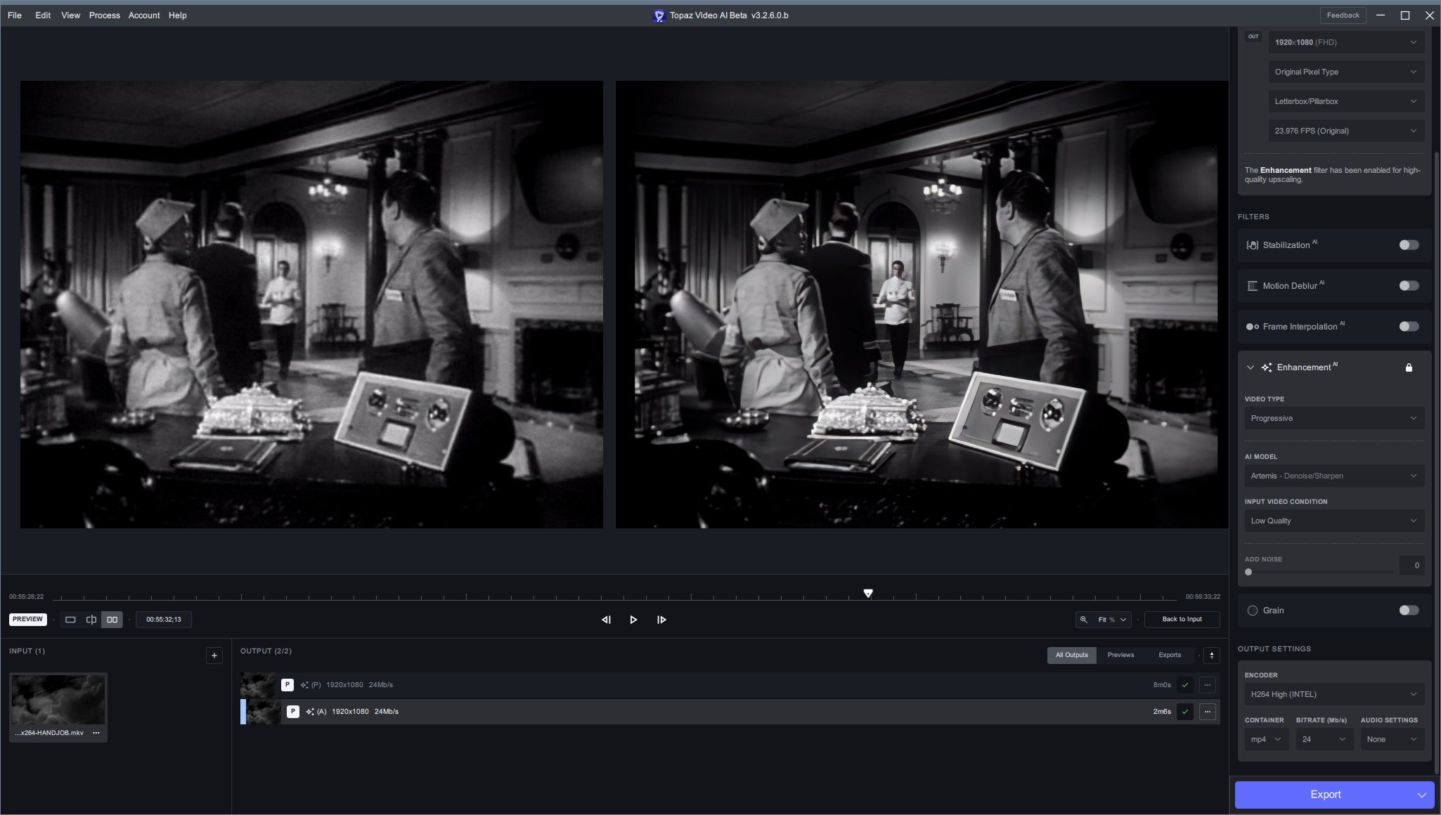

Progressive input 704x396. Upscale to FHD and crop to 16:9.
Several relative to auto Proteus settings previewed. In tweaking a few parameters I got several frames with green errors over the video.
In the two attached images I show one frame with and without the error.
