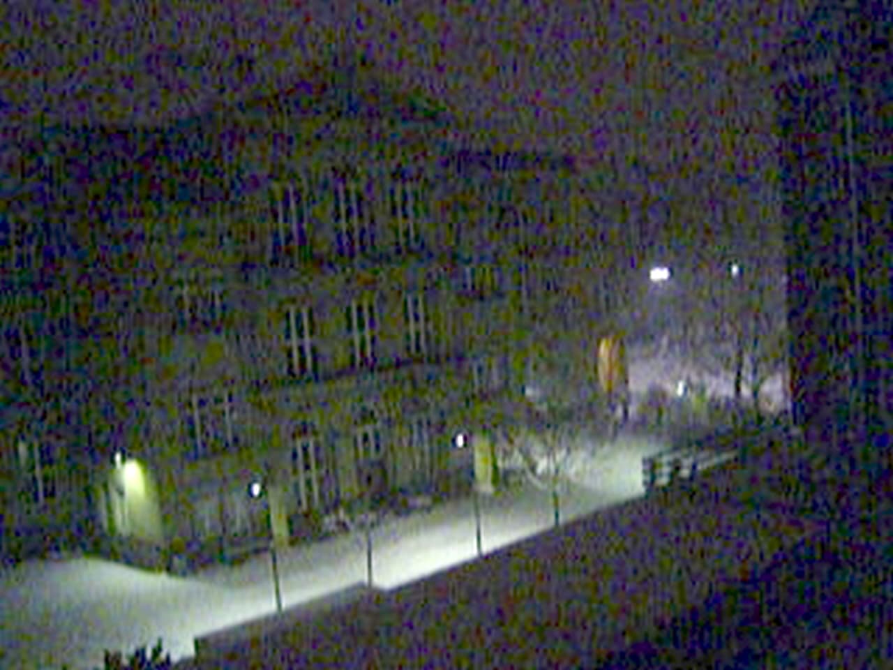

I have tested this, you are right, but the difference is minimal. But the speed difference is large. In my opinion, i prefer speed. The “lower” quality of Starlight Beta 1 is awesome enough!
Original (4x upscaled bicubic):
Beta 7.0.0.1.b: (7fps)
Beta 7.0.0.3.b: (3fps)
(you need a magnifying glass to see the difference)
The difference is not on the image. It’s on the temporal consistency. But we will expose the option to you guys. You will be able to choose less VRAM for Starlight-min
