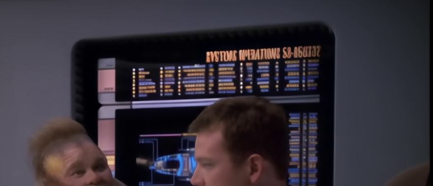

I did my first Starlight Mini Test now and gets 0.3 fps bottleneck is my “470 none TI” with only 12GB VRam. As others mentioned before, the result is good, maybe on the level of his big brother. What I see is Starlight has still problems with fonts, here an example

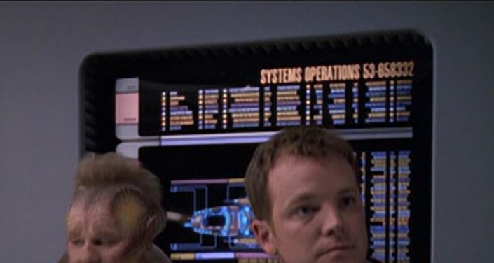

the original
