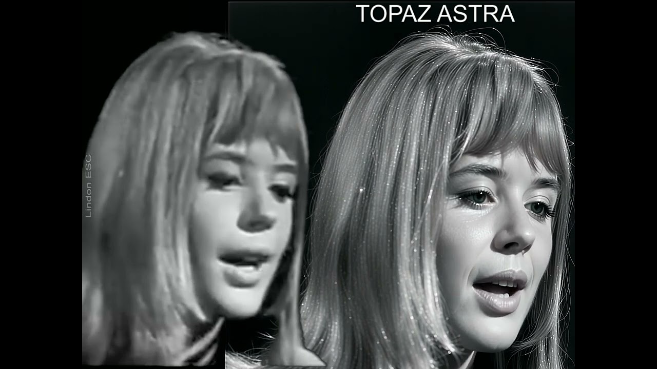

60 year old, badly archived footage. Recreation with ASTRA. Hard to say how accurate this is. I wasn’t arround 60 years ago

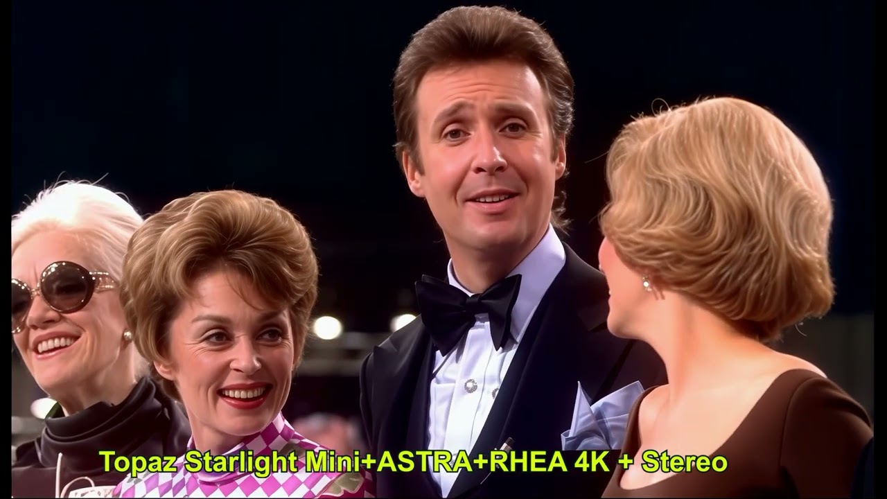

Combination of different models. Too expensive. Used all my credits. But the result is amazing if you watch it on a larger screen.
