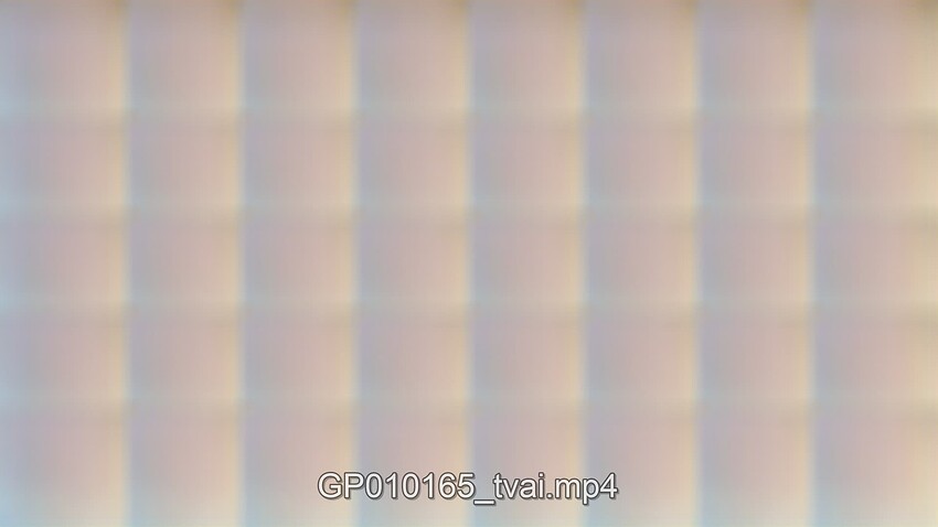

Having same issue using stablisation as i am having on release 3.0.6.
when running Stabilize on GoPro footage, I can preview (and it looks great) but when exporting to ProRes, 264, 265 (AMD or nVidia) the output video is a strange grid - see attached
Generated by 3.0.6 release
GP010165_tvai.zip (3.0 MB)
Small video of the first few dozen frames in a ZIP
Generated by 3.1.0.2.m alpha
GP010165_alpha_tvai.zip (2.5 MB)
Settings:
Stabilise (AI)
Rolling Shutter Correction ON or OFF
Strength have tried 10-30, same result for all
INPUT Video:
GoPro Hero 4 Silver - 1080p48 Linear, directly off card
Machine:
32GB DDR5 6400
AMD Ryzen 7 Pro 6850U
nVidia 3080Ti 12GB
Windows 10 Enterprise
