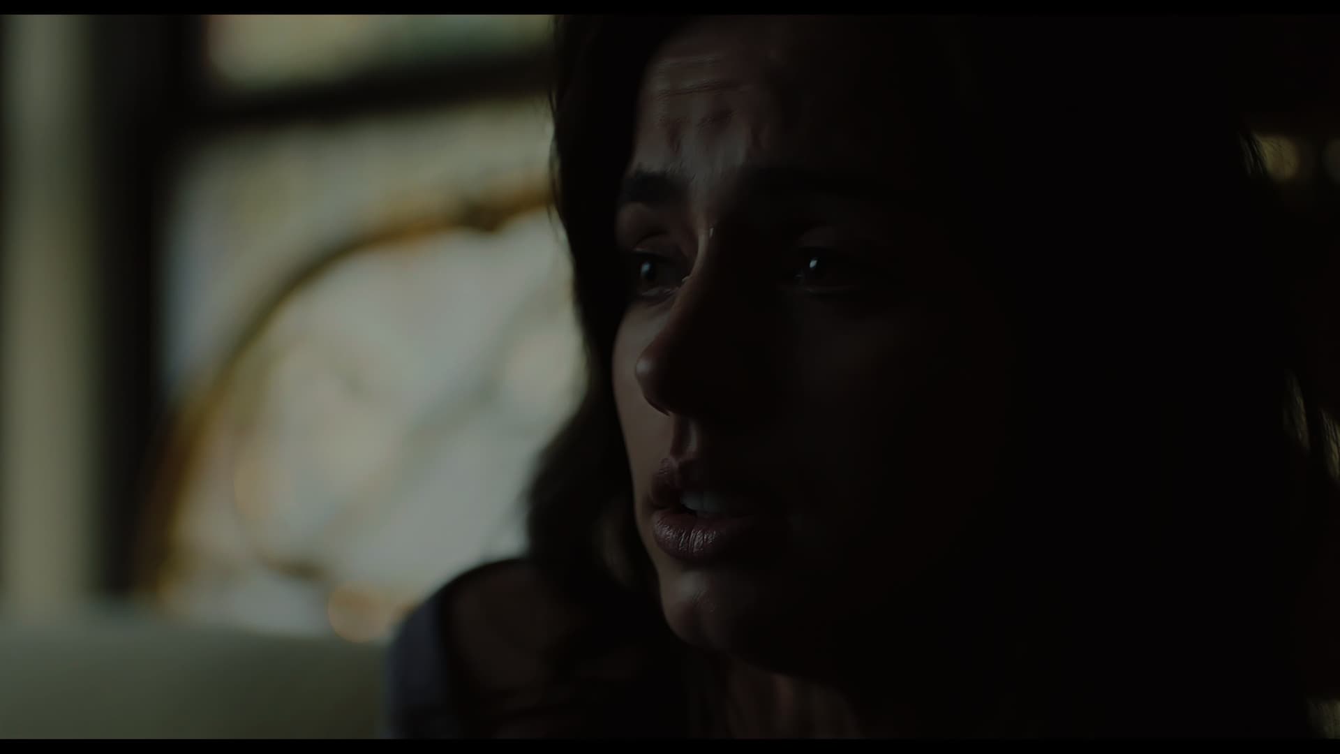

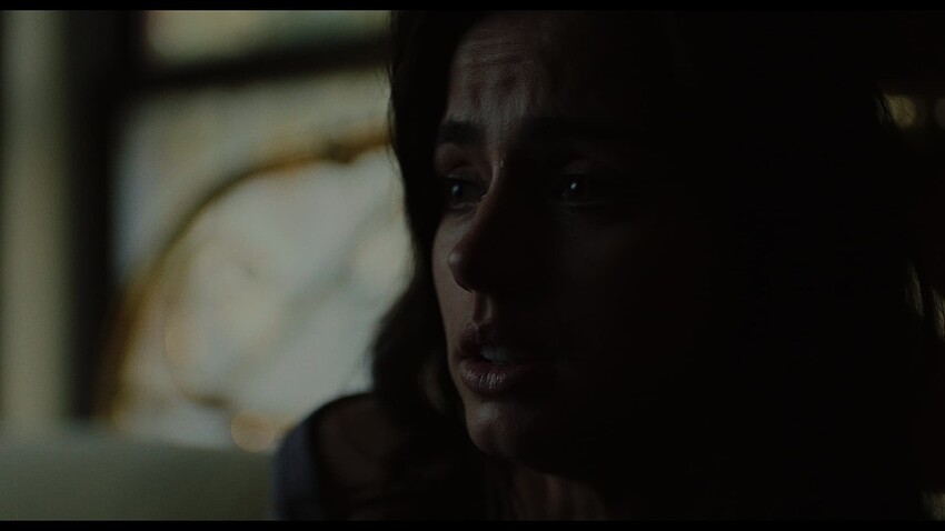

I had this happen on a DVD quality video with quite a lot of noise, so I tried a UHD Bluray quality example as well, shown below:
Original Frame (re-encoded with exact same settings as the other examples below):
Nyx XL:
Nyx3:
In just this one short scene, Nyx XL blurs and unblurs on her forehead 4 separate times. Regular Nyx is certainly less aggressive, but it doesn’t break during this scene.

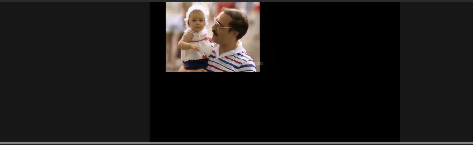

What’s up with the Focus fix in there also? I tried that and all I got was a video that was placed up in the upper left hand corner of the player.
This is the output with Focus fix on when using Slm
