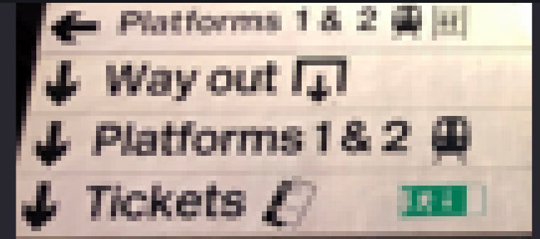

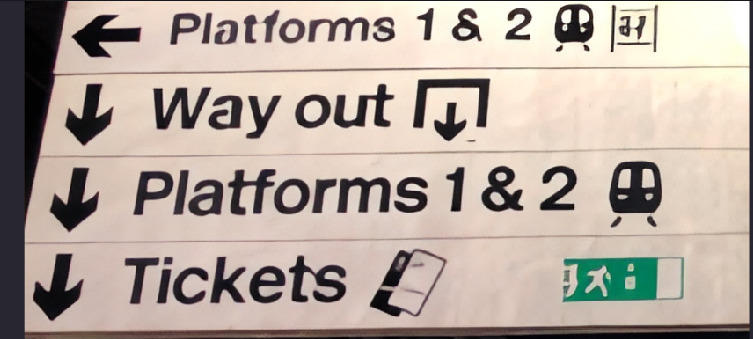

Bahaha! Behold, the true power of AI!
Great output, I have used starlight mini on some 1996 CG clips with 352x288 old CD, similar result :grinning_face:
