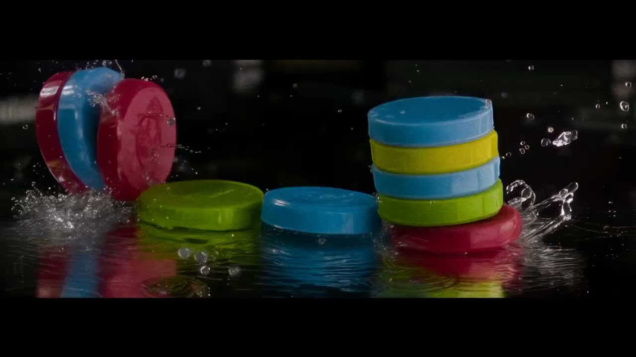

Here’s a Chronos 1.4 slowmotion clip shot at 640 x 240 at 8810 fps (367 times slowmo)! upscaled with Starlight. Once again, it does a great job of cleaning up the aliasing and moiré. It does an okay job restoring, considering the very low resolution, but it smooths out noise and textures a bit too much. Also, it didn’t resolve the flickering problem I had.
So I took the clip, did a Proteus pass, fixed the flicker with Neat Video, and added film grain. It made a significant difference. I know there’s a love/hate relationship with film grain, but after many tests, I feel it’s necessary to use when restoring a very low-resolution clip. At the moment, Topaz smooths things out a bit too much. In the video below, the first clip is the original, and the second is Starlight with Proteus, Neat Video to remove the flicker, and film grain added.
