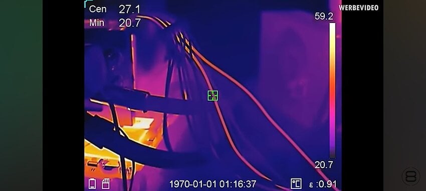

https://videocardz.com/newz/der8auer-shows-geforce-rtx-5090-fe-cables-with-uneven-power-distribution-finds-150c-hotspot
ExtremeTech has an article with the owner of the card who admitted he screwed up by not using the cable that came with his 5090 FE. He used a cheap aftermarket cable that looked cool, but didn’t meet the electrical specs of the factory cable. Der8auer has sensationalized the story, just to generate views on his channel. It’s clickbait.

Did you watch the video? His own card was pulling over 20 amps on a single wire. Two wires carrying the bulk of the load while the others were effectively along for the ride. That’s NOT okay.
