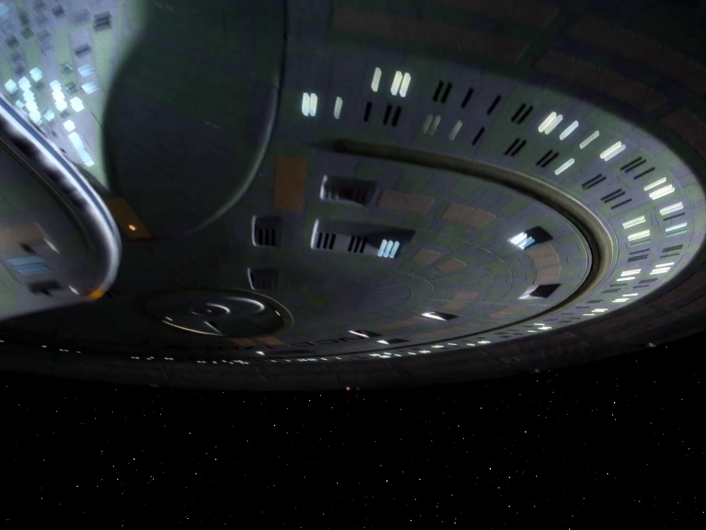

Black nebulous artifacts detected during testing.

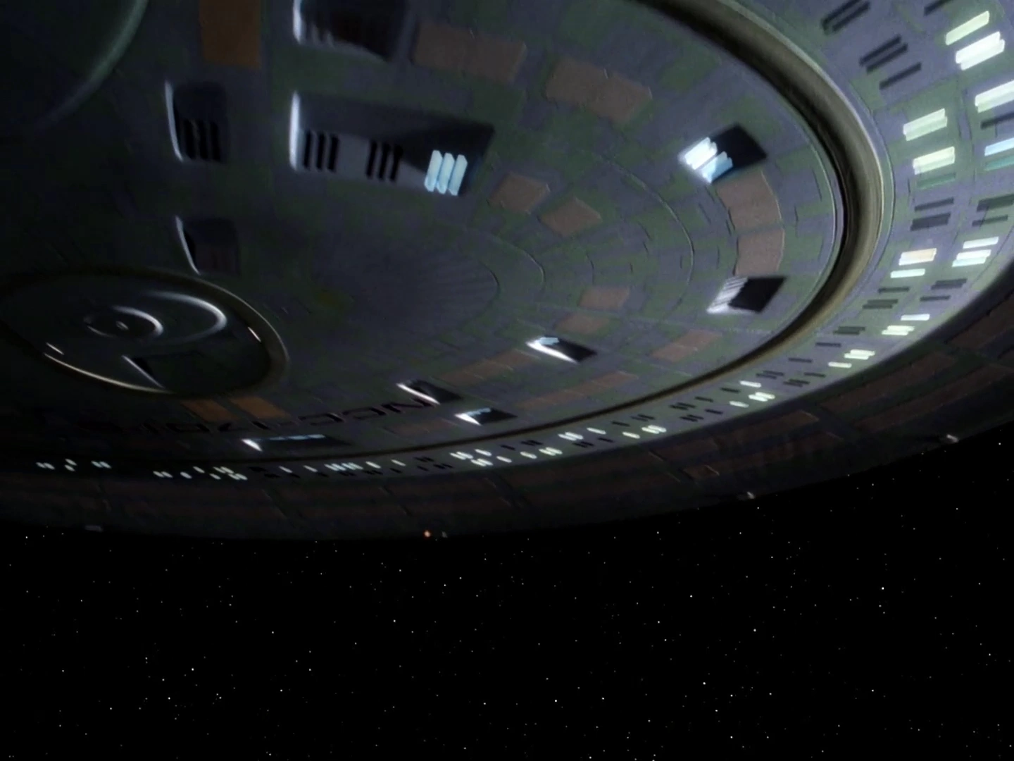

Also, on further testing it looks like source details are still being destroyed. Check the below image comparisons for the black artifacts and also see how the fine details on the saucer section are being severely smoothed out/destroyed:
I think there is more work to be done on preserving detail.
Thanks!

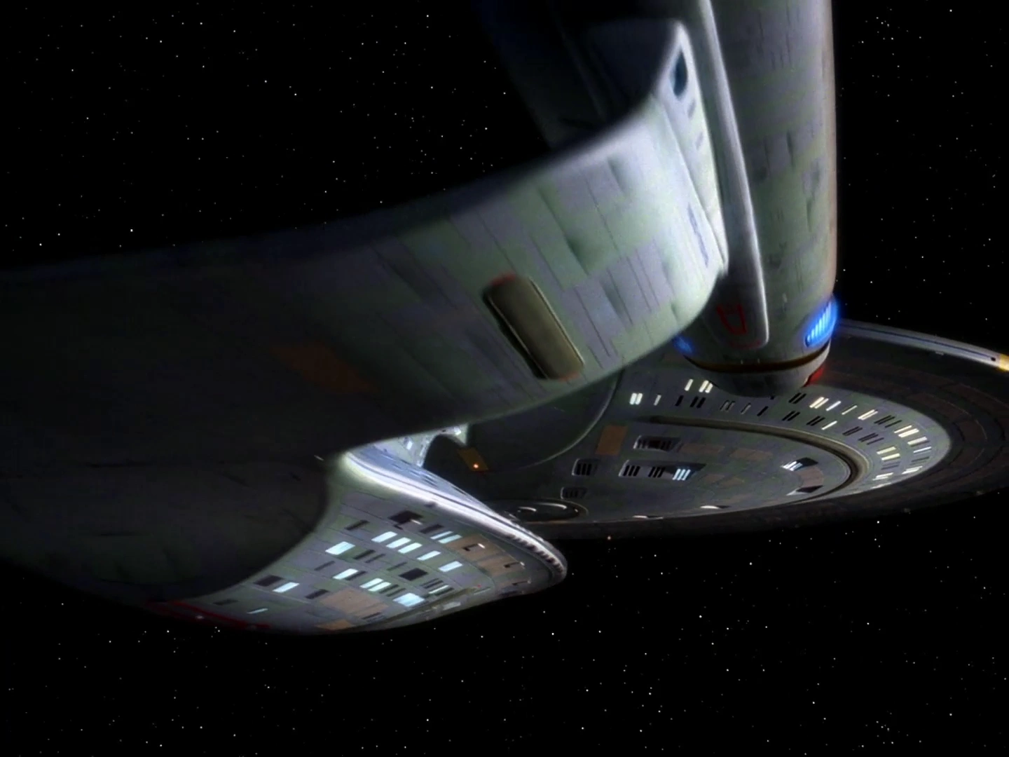

Highlighting these 2 comparisons that clearly demonstrate the loss of fidelity:
Source:
Rhea:

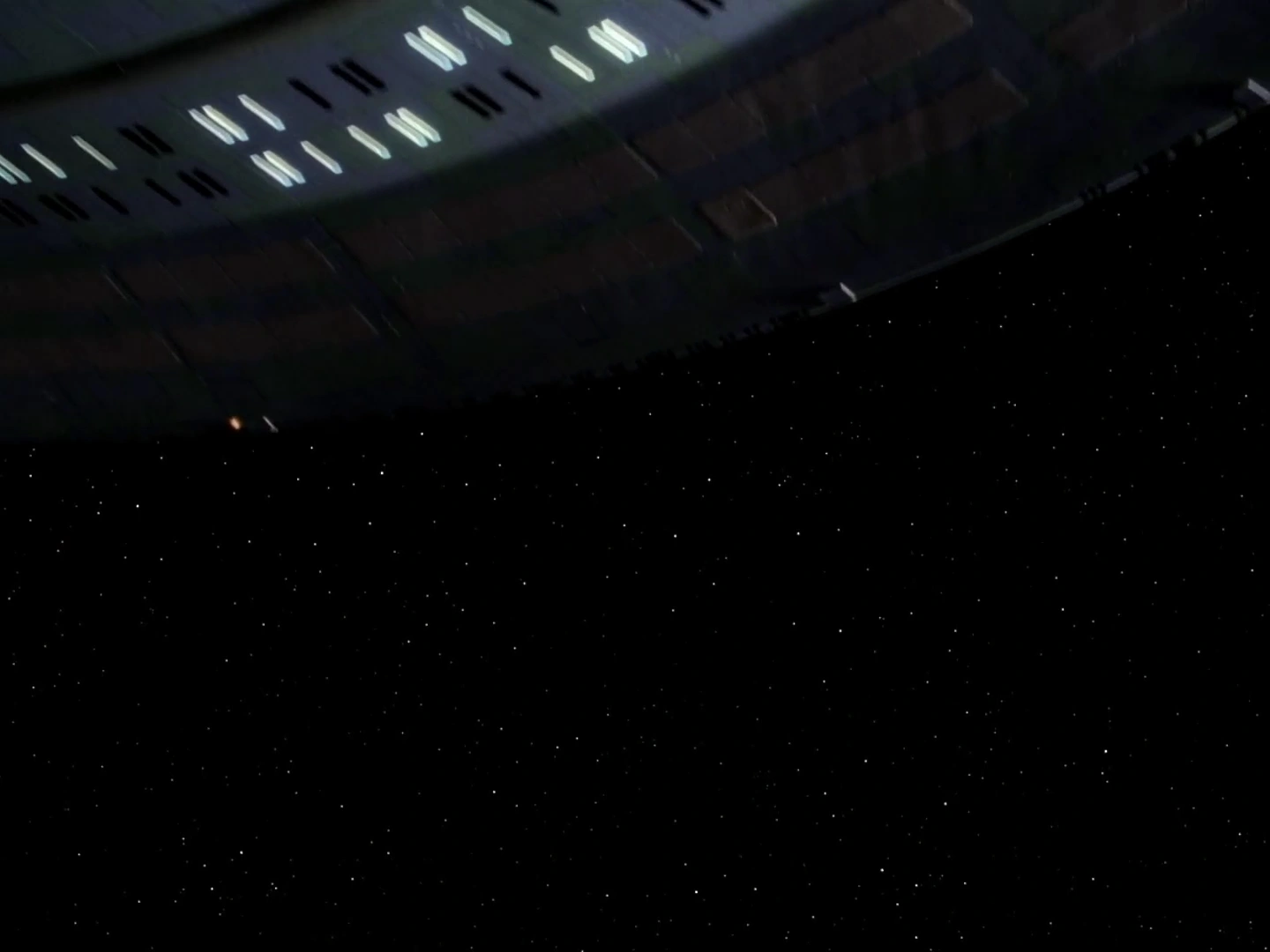

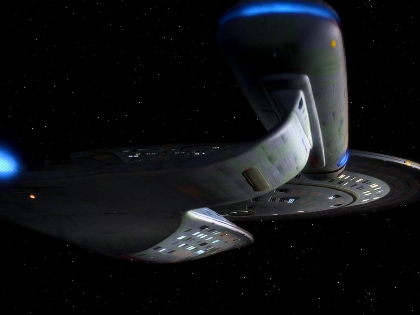

And black artifacting:
Source:
Rhea:
