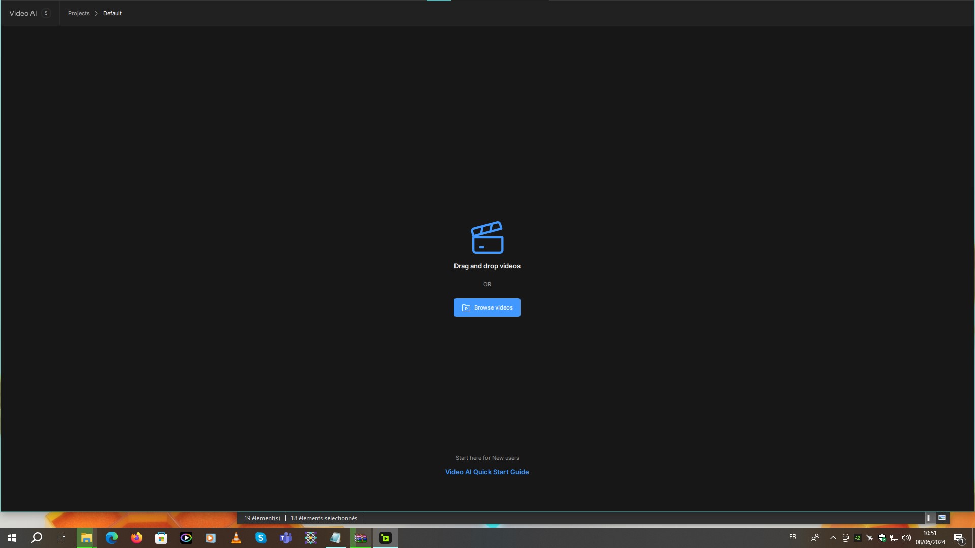

Topaz Video AI 5.1.2.0 and interface bug still unresolved. Here’s how it tends to open at times.
It’s really very frustrating
