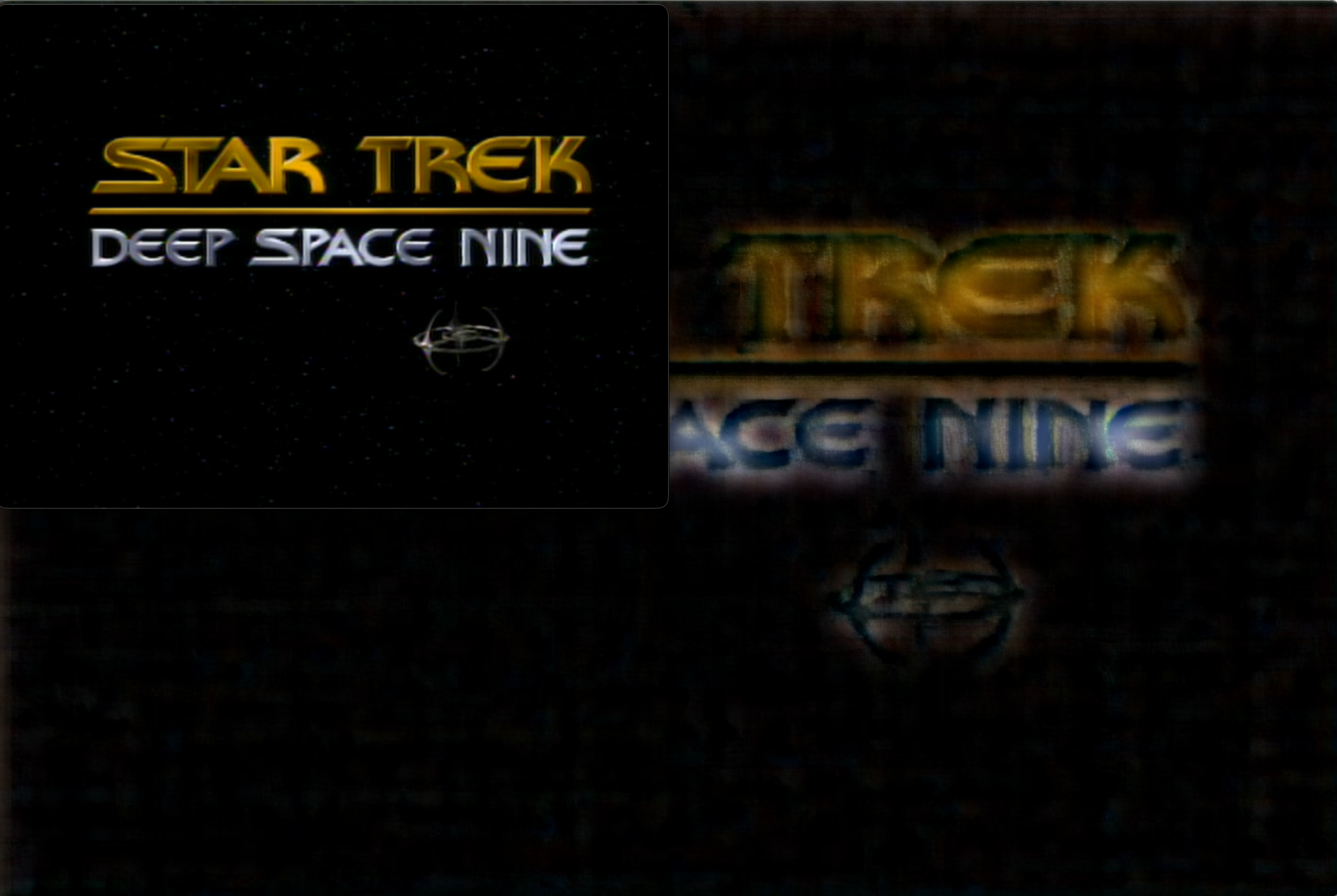

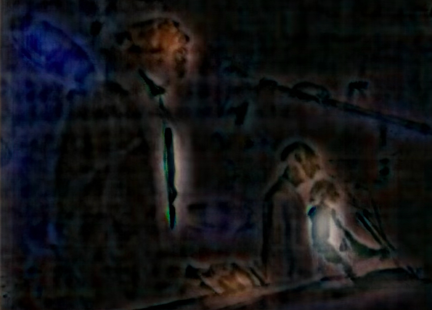

Starlight still producing the strange results that were reported last year. Also Nyx XL not working as second enhancement (OK as first enhancement). I’m on Mac Silicon.
Errm, as long as Starlight on AppleSilicon produces such results:
the output resolution is the smallest issue. Please rethink / adjust your priorities.
