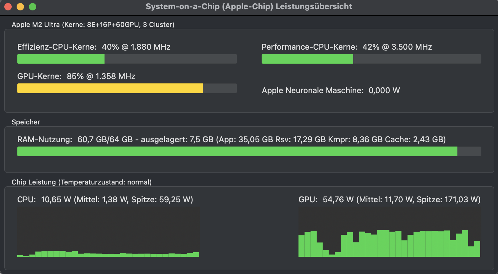

Oh, and SL mini is still eating up about all RAM at times:

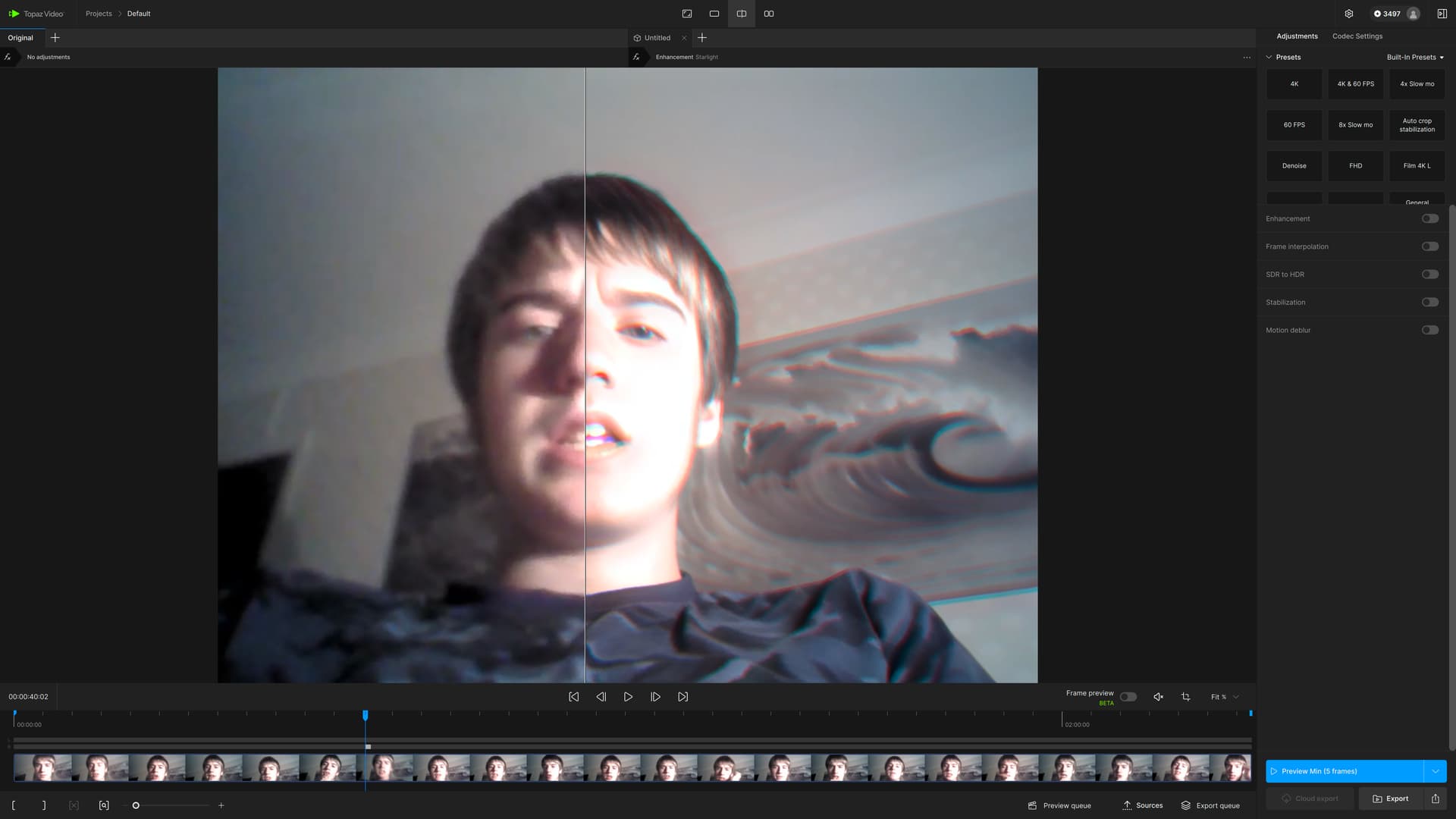

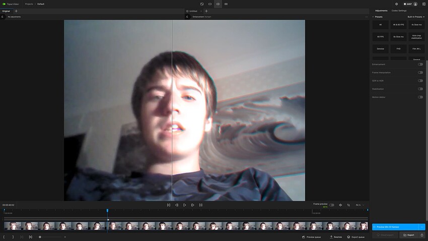

Starlight Mini still broken for me on macOS 26 (The colour channels are not lined up with the luma)…

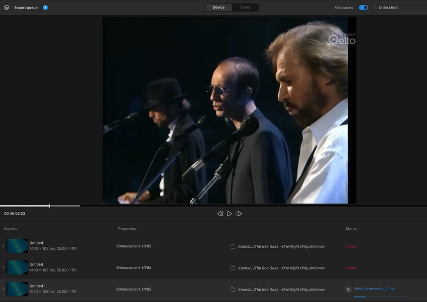

Maybe we could have a competition: who has the longest render…
OUCH!! :scream:
I don’t think this should qualify. “Remaining time” shouldn’t count, as it could have been cancelled by the user at any time. Show me one with a completed render that looks like this, and I’ll buy it.
View Export Topaz Video
By the way, this isn’t intended to be a contest submission. My longest individual render to date was in the neighborhood of 44 hours. But that was a project that was broken into 11 5-minute segments, some of which I had to run twice at 42hrs+ per run. In all, it took nearly the whole month of August, running 24 hrs/day to finish.
