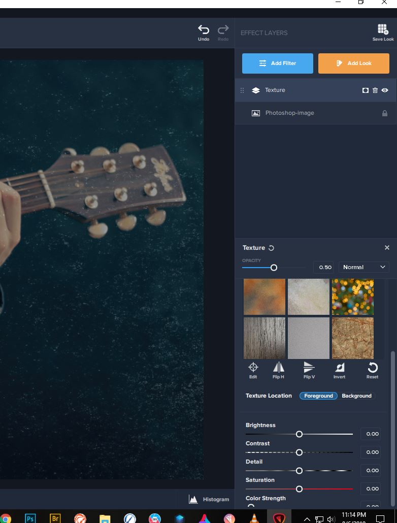

I found a problem with the bottom right hand Add Filter filters column. When I opened many of the larger filters that have many sliders, the bottom sliders cannot be seen or are barely seen. This is true for both the stand-alone and the PS plugin TS2. In particular I had the problems with the Texture, Color Theme, Precision Details, Precision Contrast, AI Remix, and Glow filters. I have attached a screenshot for you to see the issue. Not sure anyone else has reported this as I have been on travel, but it is the first time I noticed. It would be helpful if the filter panel could be adjustable or the side slider be extended. Thanks.

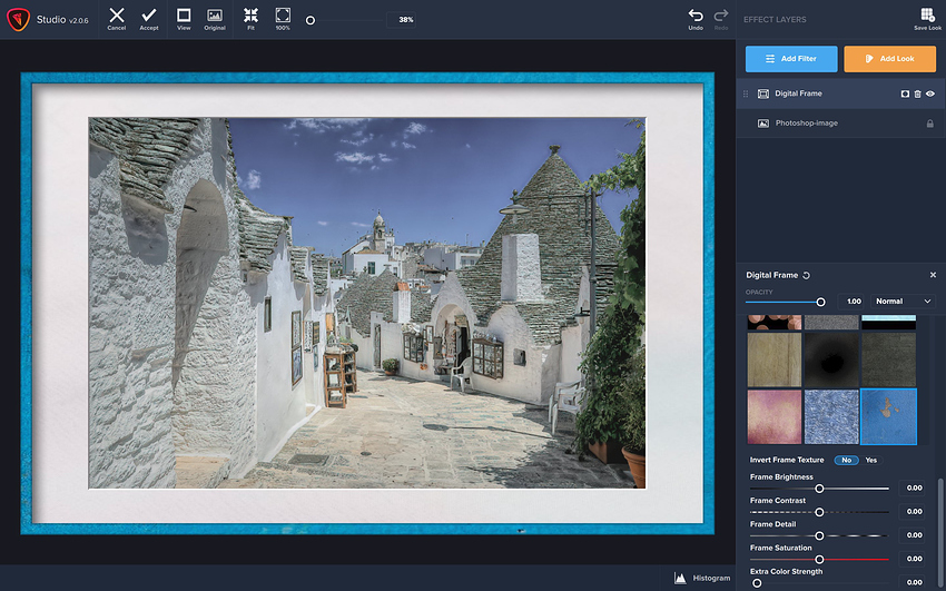

Hello - thanks for the updates - just a little plea from me to ask whether you could push the menu selections up a little bit from the bottom frame (see screenshot) - especially as higher up on the right hand side there is blank gap. I’m using macbook and get the same view whether using TS2 standalone or as a plug in with Luminar3

That gap fills up fairly quickly when you apply multiple filters, and then you have a slider on both sections.

We do have a fix for it not scrolling all the way down in the filter panel, especially on longer filters.

On some screens it was actually clipping some of the bottom controls and wouldn’t allow you to scroll down to them.
Yes, I’m seeing that too with various TS 2.0.6 tools on my Win 7 PC. Assuming 2.0.7 will remedy.
A correct assumption!

Same issue here - unable to access the bottom of many filter selections. As a result I don’t really use Topaz Studio 2. Let’s hope release 2.0.7 fixes the problem.
