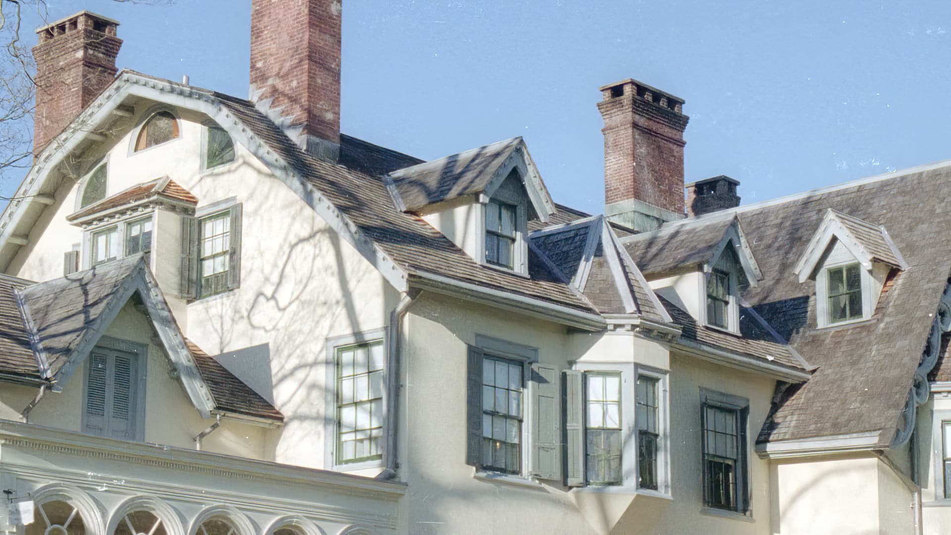

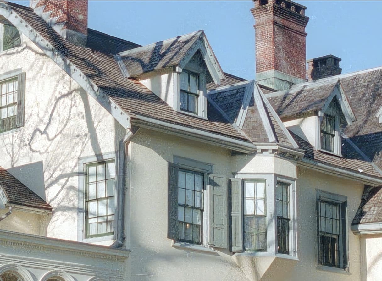

I used your original and tested it with Tack Sharp and NoNoise (I’m sure you know the app). It actually produced more detail than the Super focus version you posted. Probably Superfocus will best it on small pictures. The processing was near instant. Check the chimney and roof tiles.
Thanks, it is more true to details but looks a little schwarmy maybe.
