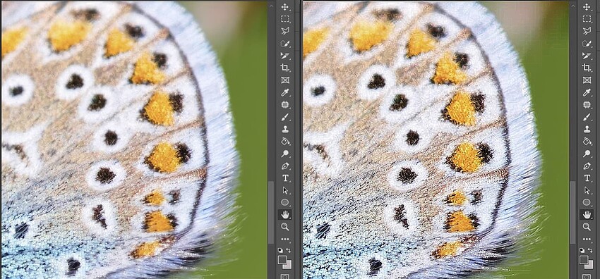

Here is just sharpen with FS applied to your image.

This method does create a white border around details and so reduce the detail resolution by a lot, details do not seperate from each other any longer.
You did sharpen the bokeh too.
Yes, you are right, we need to pay close attention to how many pixels
we separate HF from LF layer, from experience we should barely see the image.
It is not always applicable (especially not to writing, geometry, buildings, etc.), thatâs what I also specified.
For example, also on this site a sharpening on a portrait worked very well, the result was also appreciated by a tester.
âYou did sharpen the bokeh too.â
I can easily separate the sharpen by making the contrast higher (for the HF layer)
only on a selected/marked area.
PS:
On the image on this topic, i applied sharpen differently, smaller in the right area
with the application properties, and a much larger on the left area with the butterfly.
